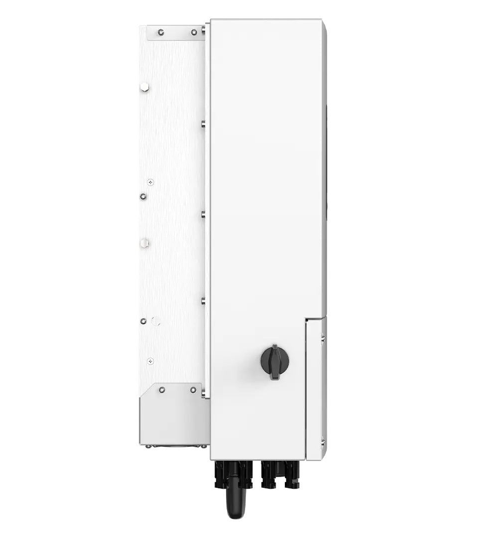

All the Solis Inverters are IP66 meaning they can survive direct spray
Power Forum Renewable Energy Store | By Powerforum.co.za
No image preview
Solis S6 Pro 8kW Plus Hybrid Inverter (S6-EH1P8K-L-PLUS)...
Shop highly efficient Solis S6 Pro 8kW Advanced Hybrid Inverter that allows the user to hit those ‘parity’ targets by managing power coming from multiple sources such as solar. Request a Quote now!
