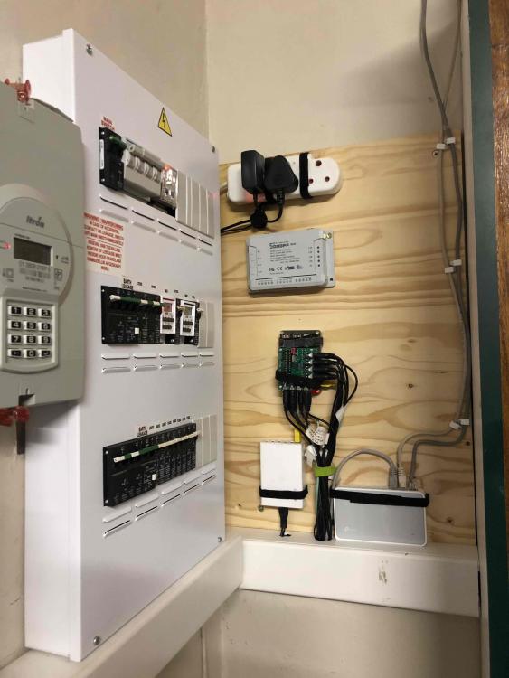

    System is in... now to get use to it, figure out how everything works. Next up when I'm there in 2 weeks will be installing some additional CT's and a Rpi running Home Assistant and 2 Sonoff's, t
  • I don't think you're trying hard enough. Surely you could just take the box off the wall and have a look at the brand. 😉
  • Uuuurgh OCD hit - timers say different times... But nice - all in one.

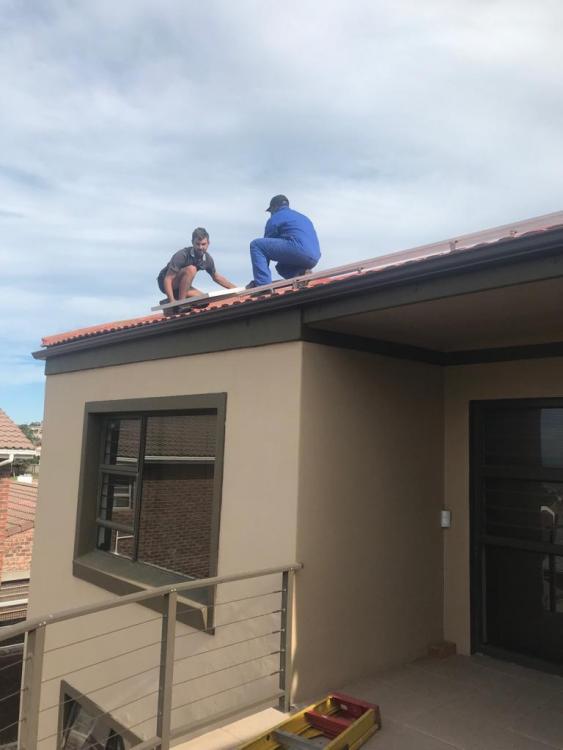

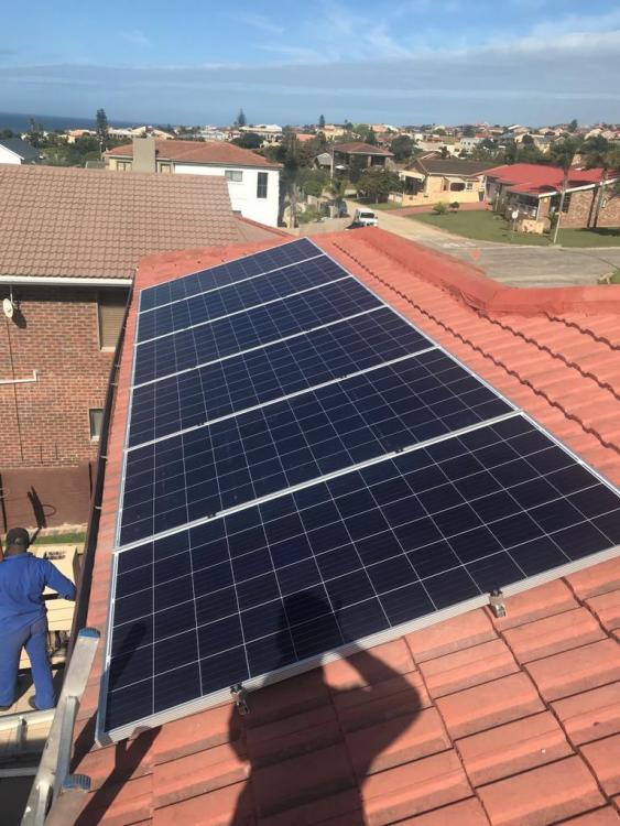

And the panels are going up... 6 of the 9 yesterday, remaining 3 today and then the back board with inverter, CC, VenusGX today, if all well it will be commissioned today, otherwise tomorrow.
G

will be running a 3S2P string onto a dedicated BlueSolar 150/35 facing NE and a 2nd string, for now only 3S onto a 2nd BlueSolar 150/35 pointing N, will be expanded later by a 2nd set of panels, 3S, giving me 2 arrays each of 3S2P each onto a dedicated MPPT.
Have place for another 6 panels, will be on a 3rd 150/35 when they get fitted.

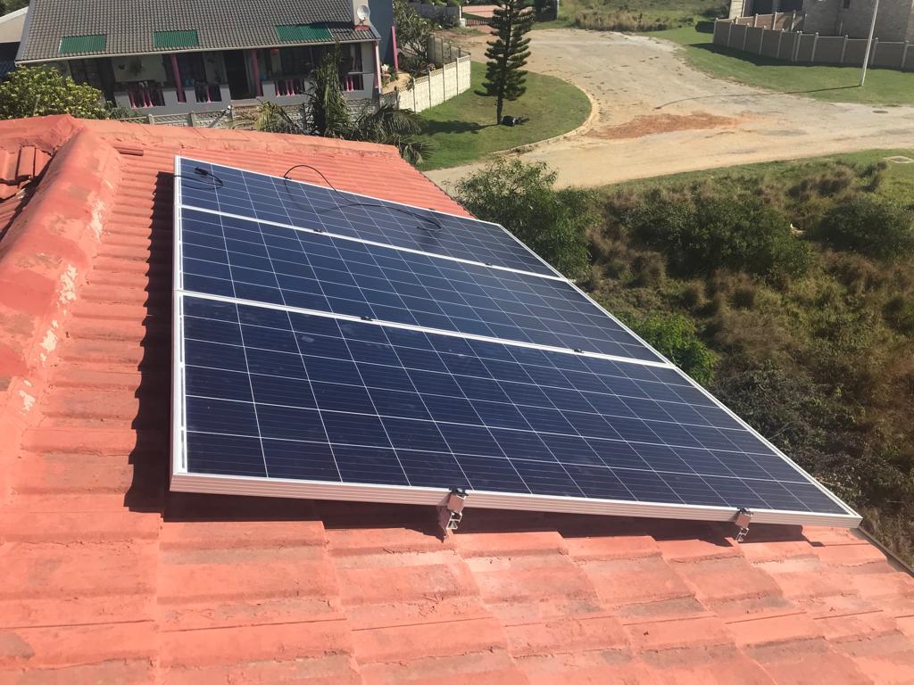

10 minutes ago, Sean said:
Is the upper clamp in a zone ?
I would have preferred that it be 3cm higher... but that is nit-picking. It is in zone.
3 minutes ago, georgelza said:
huh ?
I think the angle the photo was taken at makes this look worse than it is. The 25% optimal point is where the red arrow is. This is surely close enough 🙂
Thanks, will have to have a look. know the installer battled to get the rails up, something to do with my roof not using standard brandering under the tiles.
Will get him to sign off and then inspect in 2 weeks when I"m there.
G
i would have thought maybe one tile to the right would have been a better place.
wider the clamping spacing the more leverage it would have.
G

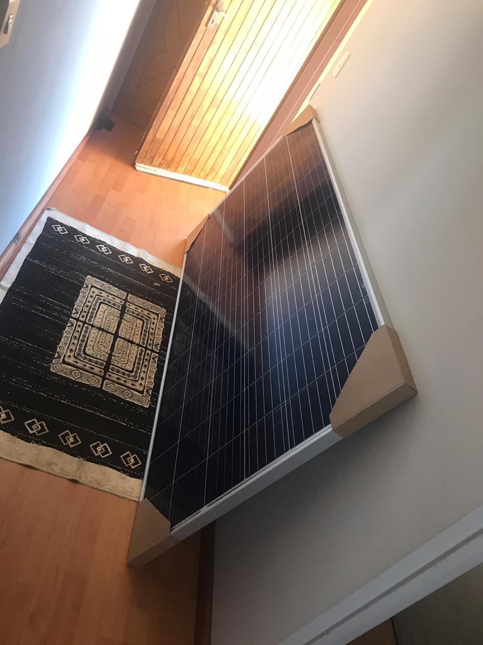

ps... these are AmeriSolar 330w panels, 72 cells each.
