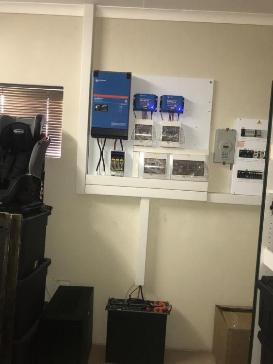

    System is in... now to get use to it, figure out how everything works. Next up when I'm there in 2 weeks will be installing some additional CT's and a Rpi running Home Assistant and 2 Sonoff's, t
Next up when I'm there in 2 weeks will be installing some additional CT's and a Rpi running Home Assistant and 2 Sonoff's, to start getting familiar with them
got some more plans, some re-wire of some plug points... onto a non essential line.
G
 just switch over to grid, for now my system is configured to cycle batteries down to 50% every day.... mind you they only started with a 55% charge when system was commissioned this afternoon, will be nice to see what we get from PV from tomorrow. for prob 90min this afternoon was only drawing like 10Watt from the grid.

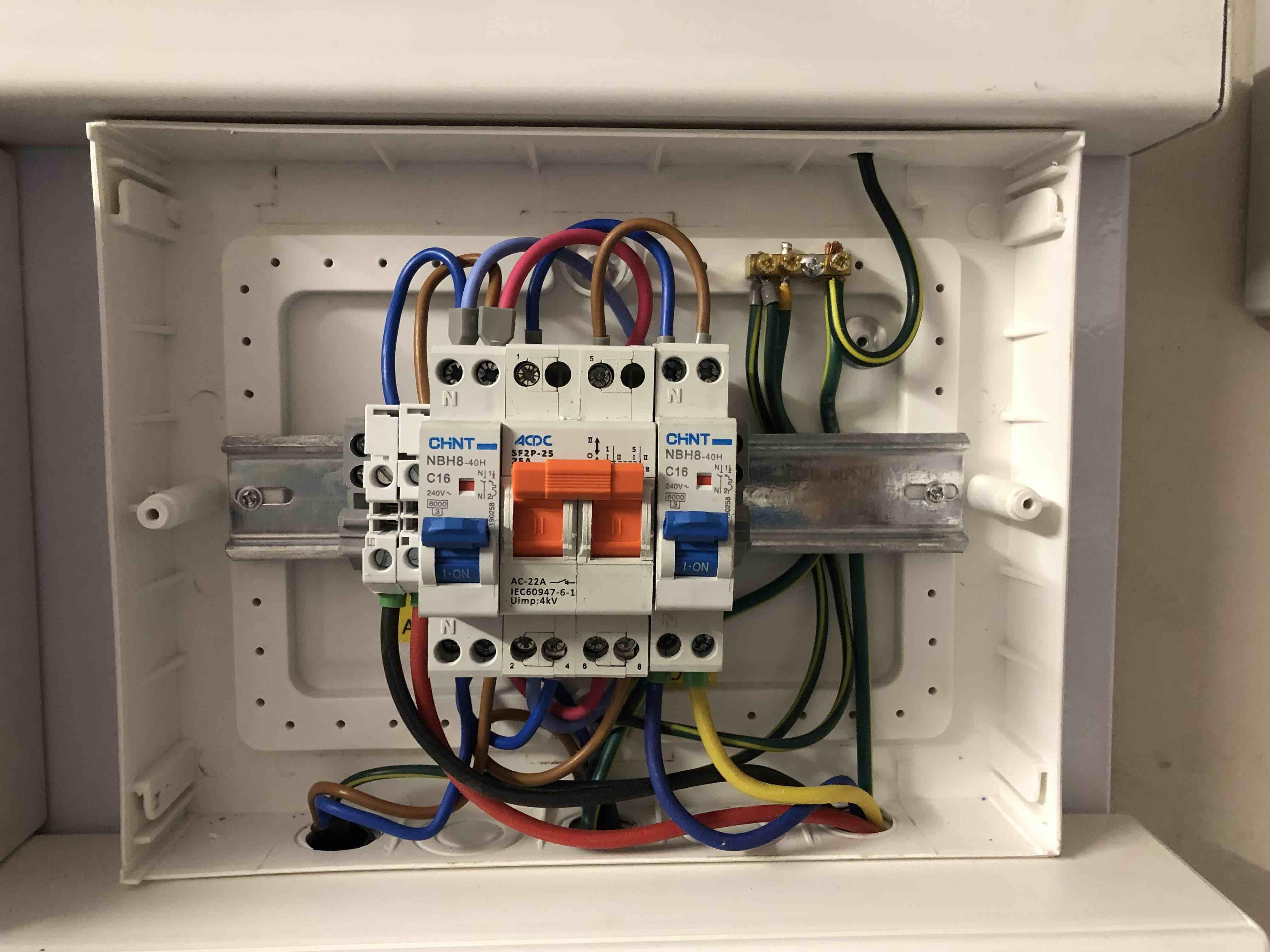

Just a board...
Rail #1
Main Isolator
2 way switch, Grid or Geni
ET112
Rail #2
Rail Isolator - 60 Amp
Rail Earth Leakage
Oven - 40amp
Geyser 1 - 20 amp
Geyser 1 - Timer
Geyser 2 - 20 Amp
Geyser 2 - Timer
Pool - 20 Amp
Rail #3
Rail Earth Leakage
5 x Plugs - 20 Amp
3 x Lights - 10 Amp
G

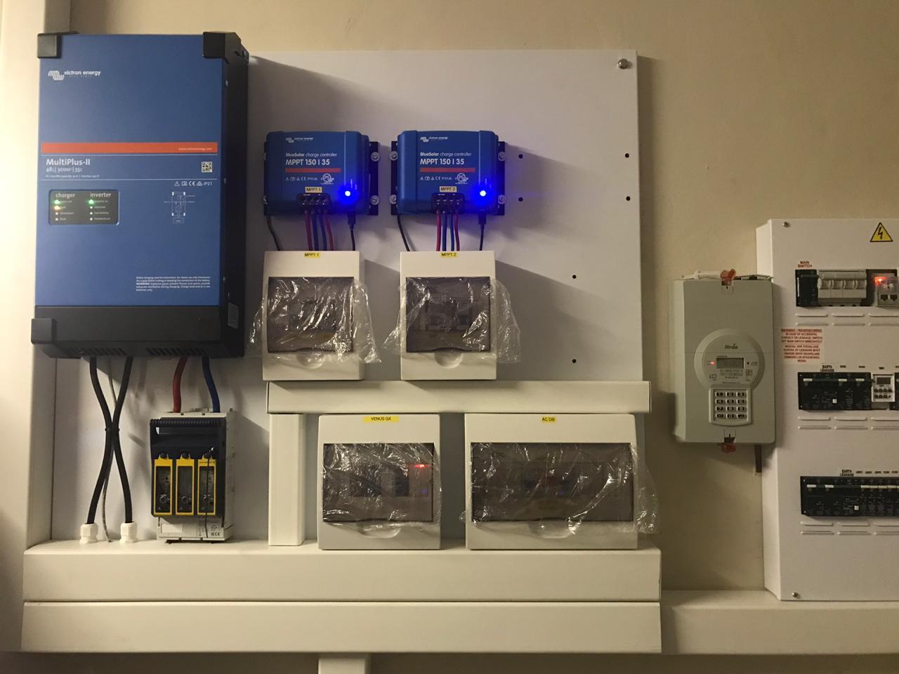

ohhh. Lets see, below the 2 x MPPT's - Isolator box.
Line comes in, goes into a double pole isolator, into a fuse and then into a disconnect, and out to a bus bar (located bottom right). - same config in other MPPT isolator box.
Same bus bar  the battery connect to and the inverter.
Battery has a quick disconnect/fuse switch, bottom left. Battery goes into this, and then from here to the box bottom right.
Box bottom, 2nd from right, contains the VenusGX.

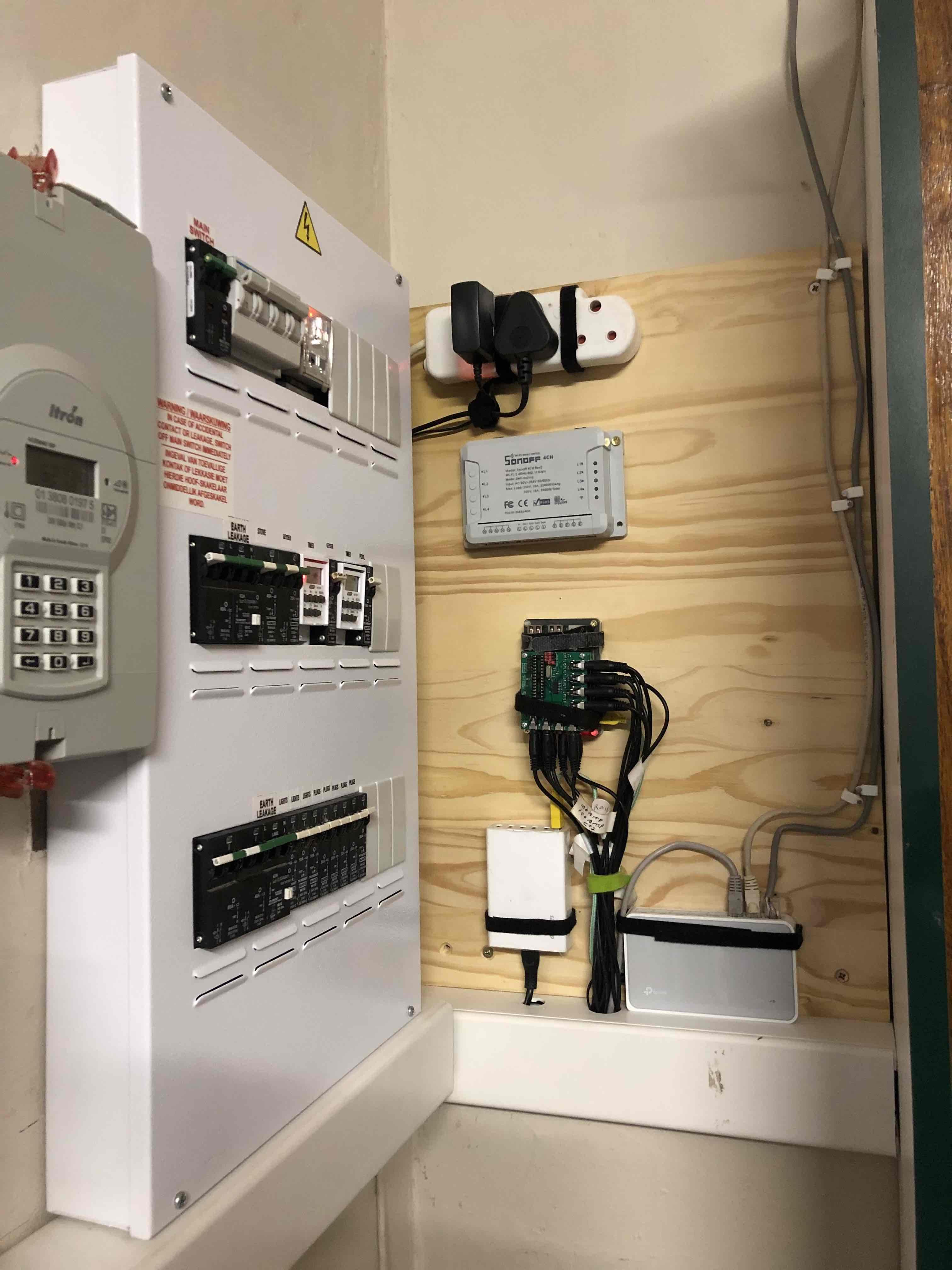

A before and after cleanup of the IoT board, not done yet, some trunking is to be fitted. Still deciding if I'm going to move my RPi with Home Assistant here.. to the board or if I will leave it  in the study.
The sonoff 4C at top will be used to switch some contractors (yet to be bought) via either a sonoff based schedule or a Nore-Red build schedule that will control the Oven, Geyser1, Geyser2 and the pool,
Already in place / installed this weekend.
sonoff/basic (+BME280) - Garage right Light - on timer
sonoff/basic - Garage left Light - on timer
sonoff/basic (+DHT22) - Girl room bed side light - on timer (they forget to switch it off/repeateded)
sonoff/basic (+DHT2) - Boy room bed side light - on timer (they forget to switch it off/repeateded)
sonoff/POW R2 - Dishwasher - (will be switched off if Eskom feed is lost)
sonoff/POW R2 - Washing Machine - (will be switched off if Eskom feed is lost)
sonoff/POW R2 - Tumble Dryer - (will be switched off if Eskom feed is lost)
sonoff/POW R2 - Kettle and Toaster - (will be switched off if Eskom feed is lost)
sonoff/4C - To be configured to manage 4 x contractors for Pool, Geysers and oven -  - (will be switched off if Eskom feed is lost)

@georgelza maybe it is just me but I just don't like stuff that generate some heat in boxes.
If I was you I would check the temp of the VenusGX on a hot day working hard when it is enclosed in a box.
If you use the WiFi on the Venus-GX, definitely leave it outside! Also, it has an sdcard reader and a USB plug and if I want to get to it I don't want to unscrew things first... 🙂
But if dust-tightness is a concern, then by all means put it in a box.
