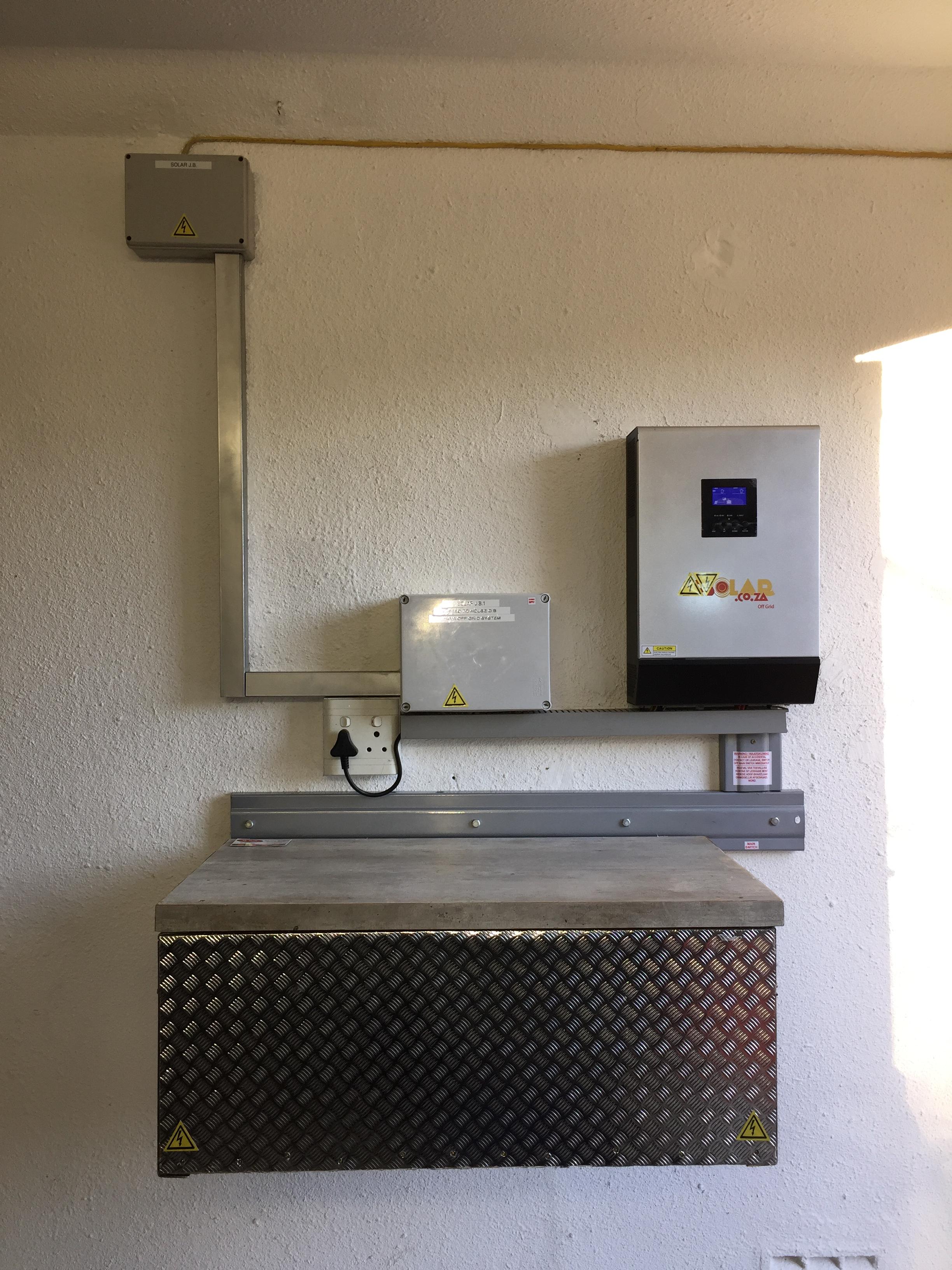

5KVA Axpert clone with 4 x 320W panels and 48V 120Ah gel batteries
Very nice! More than halved your bill, with some backup for load shedding all for R50K. Money well spent. The saving will only increase in the future.

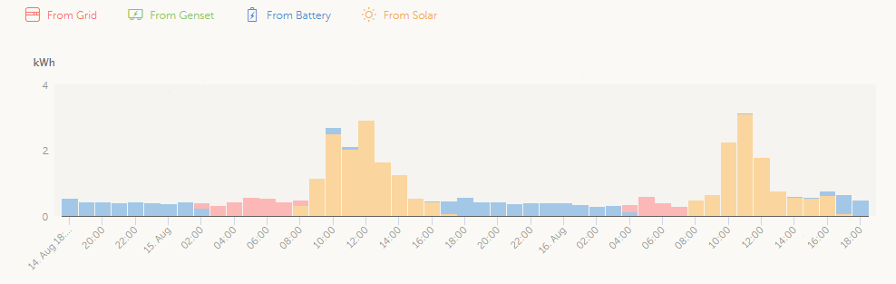

Savings, before the last increases, we dropped, based on spent before to spending now, about +-R1200 per month (and it is increasing the closer summer is getting) from before grid tied to after grid tied (no feeding back to the grid). I simply schedule the high end loads daytime like geysers, dishwasher, dryer etc to run at optimal solar times so that I can use the 3.5kw array as best I can.
This is on non-optimal solar the last two days, max PV is about +-2.8kw AND I took off the grid +-500w from 12am-7am.
Batteries are charged 100% by 5pm each day.
As I said, have not seen consistently over 3kw yet ... rain and farmers see.

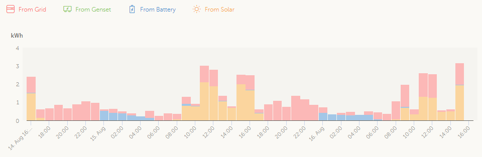

Here is my last few days and i am also running two geysers on timers (manual).
Initially when i purchased my solar i had no intention on running the geysers off solar, but i tried it and it seems to be going great. I can do with one more pylontech though :)
Now, the thing here is, going over to solar made us work smarter. I used to use close to 50kw a day ... now we am doing around 21kw a day. My bill was around R3.5k per month, and is now MAX R500p/m that includes a R90 connection fee.
When it comes to saving on your monthly bill, the best way to do it is to save on electricity usage.
... and those red bars does not make an appearance if i do not game until 2am :)
Edited by stoic

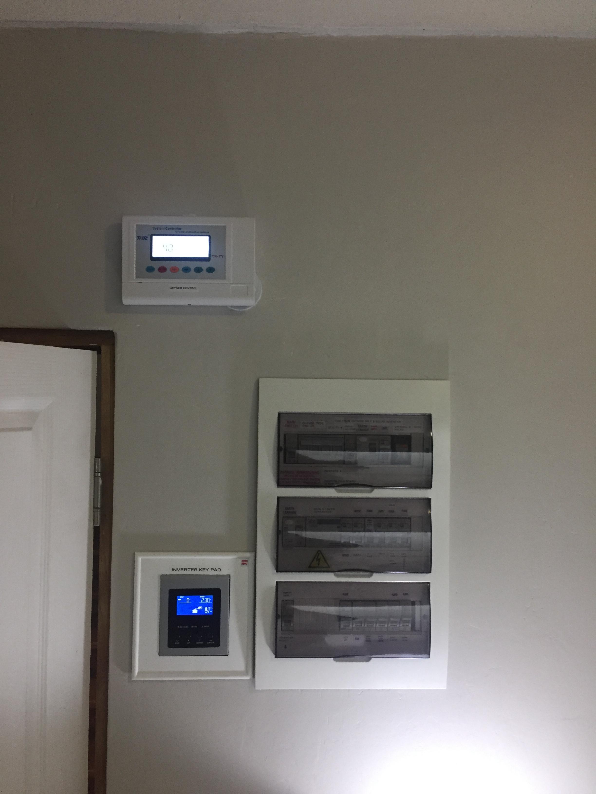

The geyser Is a high pressure 200l ltr with evacuated tubes. Its tubes fit directly into the geyser with no pump or electricity required. But it has a 2KW element for backup.
My old electrical geyser was a 150 ltr and when I decided to go solar I read somewhere on this forum that it’s better to upsize a little when going solar to ensure you have enough hot water. So I went for a 200 ltr and it is working great for a family of four.
It has a Very cheap R450 solar controller to see water temp and to set 7 day timer and temp requirements. I have set mine to come on only if water drops below 33 Degrees and that basically never happened only on occasions when the wife fills the corner spa bath, but even so the rest of the boys can still shower. It has a bypass function that I press only when the spa bath was used. This is for winter so I still need to see what its going to do in summer. The geyser is very well insulated and water is more than sufficient the next morning, the max I saw it drop was about 4 degrees and that was with very cold weather about a month back.
My water goes up to about 80 degrees after showers in evening it shows about 44degrees but that is still sufficient for morning shower.
The controller is on top at DB. on picture

The R1086 / month was just the saving year on year on prepaid power that I would normally buy.
What I done is installed a small KW hour meter at my inverter output to measure my solar usage. This comes to 75 KWH/month and this is basically an extra bonus, so based on what Eskom would of charged me for this = R145 at their R1.94/KWH Rate.
I added this R145 to my actual monthly R1086 saving.= R1231
When I add more pv panels to my system I should be able to increase the R145 bonus generation and might at the same time reduce my monthly prepaid buy.
I run completely of grid from 8H00 to 17H00 set on sonoff timer and if my batteries are still full at night I sometimes use batteries to get extra little kwh out of the system.
