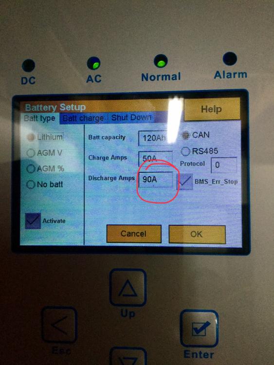

Mikel Posted March 29, 2021 Share Posted March 29, 2021 @Backbone Energy i have 2 6.4kwh batteries connected to a 5kw sunsynk inverter. What is the discharge rating that I should use (amps). My installer had it at 120A, but I reduced it to 90A based on the data sheets I have seen. Am i correct - see below Quote Link to comment Share on other sites More sharing options...
Backbone Energy Posted March 30, 2021 Share Posted March 30, 2021 best practice would be charge @ 80ah max discharge is 210ah battery capacity 250ah this subject to parallel with communication into the Sunsynk and communication between each battery. question: have the dip switches been changed to accommodate second battery? Quote Link to comment Share on other sites More sharing options...
