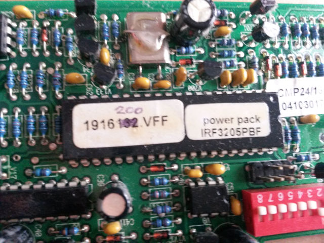

With that said, I know someone's already knocked off the MPPTs, or made one that looks the same. The Fanpusun.
Another possible reason: The Axpert uses "standard parts", at least part numbers that can be recognised as a Texas Instruments such and such. I'm not even sure what is used on the Victron. It looks a bit like a high PIC microcontroller, but who knows.
(Picture is of the old 19-series processor). Also note the part number of the MOSFETs on the sticker to the right :-)
6 hours ago, Coulomb said:
Wow. You don't see much through-hole electronics like that any more. That could be a part of why it's so expensive - using more expensive PCB assembly methods. I'm not saying it's bad, just unusual to see these days.
For small volumes, old-style might in fact be cheaper. I have no idea what kind of volumes they do on the smaller inverters. This is a 3-year old 1600va.
