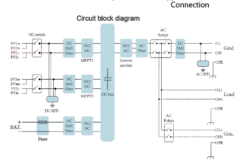

I suspect the dip is as the grid disappears the voltage dips until the relay opens. There will probably always be a very short dip. It will be interesting to note if others have been able to elimiate or reduce this dip. I notice it on the LED lights every time load shedding kicks in.
There's the rub, the Sunsynk does not switch to mains, and then switch to batteries / solar. It seemlessly blends to lot. The downside is when the grid goes down, it needs to open the relay that connects the UPS to the grid. In that moment it seems to dip for a short while. The dip is visible on my lights that run on the UPS output but we're fortunate that none of our appliances seem to care.
My thinking is that the grid goes down and pulls the AC voltage down throughput the entire inverter until it detects and opens the AC relay that goes to grid. Looking at this block diagram I don't see how it can open fast enough to not have a short dip on all outputs. Notice there is no changover relay. Perhaps the grid voltage low (brownout voltage) can be set more aggressively so it cuts out sooner. Mine is set to 185V from the factory. Worth a try perhaps.

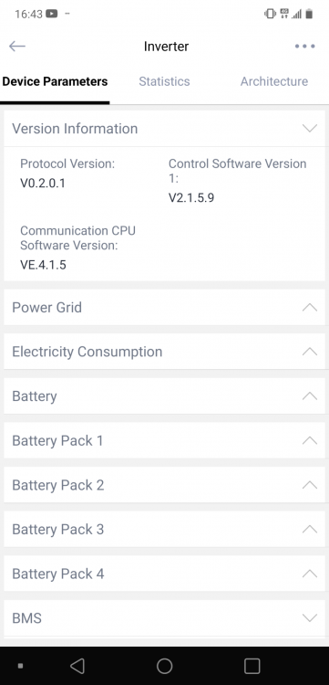

sunsynk updated the firmware of the inverter. Im hoping this solves the dip issue.

what version number did they update it to?
