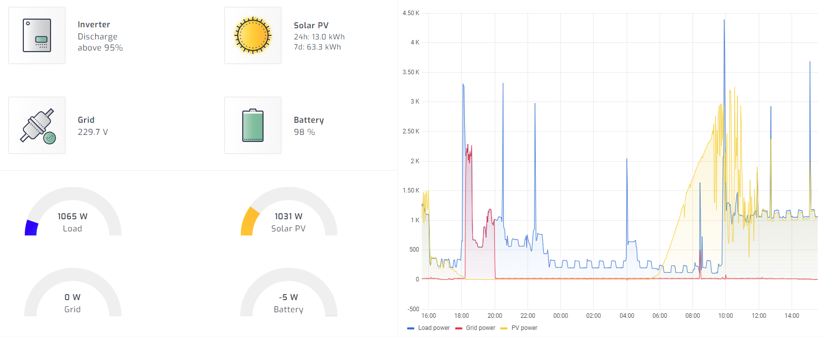

  • nice, here is mine

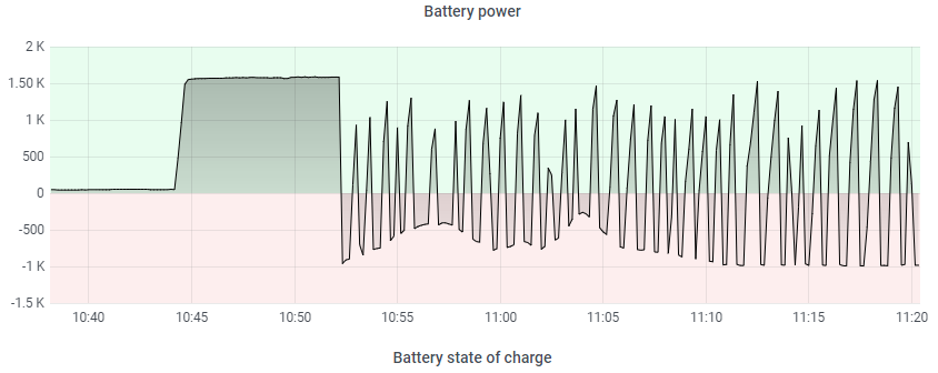

So I have enabled Grid Charge and below is what the system has been doing to the battery for the past half hour or so.
Is this acceptable with the change so much between battery charge and battery usage to keep the battery at 95% SoC?
Seems normal , 95% is quite high soc to keep for in case loadshits happens? do you need that much battery for a loadshed? ive determined i use about only 40% of my 7kwh battery so i generally just make sure i stay above 60% soc in the evening then down to 10% in the morning ,so even unexpected loadshits dont affect me .
