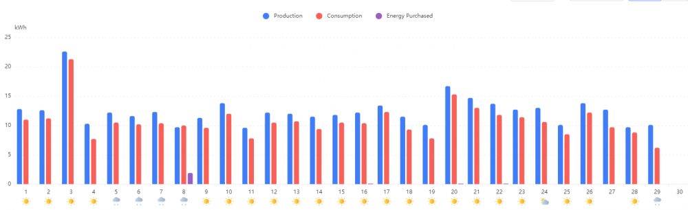

  • nice, here is mine

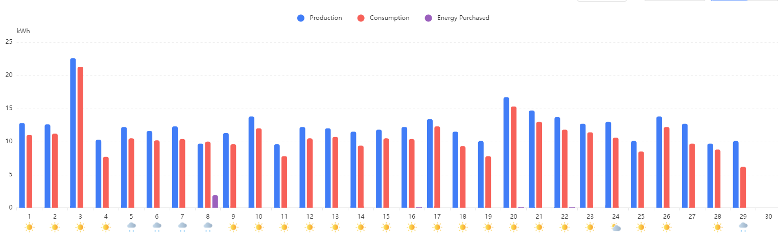

Morning All,
Just an update on what has happened over the past few weeks since I started exercising my battery on a daily basis.
Here is what I have managed over the past 30 days.

2 hours ago, MdF said:
Morning All,
MdF
nice, here is mine
Phil, your Grid / Purchasing values are very low - well done indeed 🤑
Edited by MdF

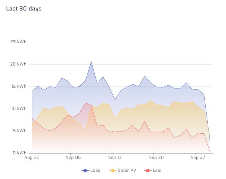

1 minute ago, YellowTapemeasure said:
It will get better over time.
ooh nice, what's the size of your battery?
Most of the usage is late in the afternoon when the wife decides to use the oven😞
