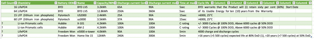

October 26, 20214 yr 2 hours ago, Nexuss said: Yes you are correct, just limit the charge /discharge rate on the inverter to 100Amps for the AM-2 (50 Amps for the UP5000). On your second point , yes they will have a difference in cycles but this is not really something to stress about, especially if they are only 1 year apart. Please educate me, how did you come up with 50A for the UP5000? The usable capacity of that battery is 4560Wh, which roughly gives me 95A and the spec says the battery is a 110Ah battery. Am I missing something?
October 26, 20214 yr 8 minutes ago, hoohloc said: Please educate me, how did you come up with 50A for the UP5000? The usable capacity of that battery is 4560Wh, which roughly gives me 95A and the spec says the battery is a 110Ah battery. Am I missing something? Hi there sure thing . From the Spec sheet: Charge / Discharge Current (Amps) 50A(Continuous) 74-89A(60sec) 90-200A(Peak@15sec) https://cdn.shopify.com/s/files/1/1178/7780/files/Pylon_UP5000_4.8kWh_Li-Ion_Solar_Battery_48V.pdf?v=1623737342 Edited October 26, 20214 yr by Nexuss
October 26, 20214 yr 1 minute ago, Nexuss said: Hi there sure thing . From the Spec sheet: Charge / Discharge Current (Amps) 50A(Continuous) 74-89A(60sec) 90-200A(Peak@15sec) https://cdn.shopify.com/s/files/1/1178/7780/files/Pylon_UP5000_4.8kWh_Li-Ion_Solar_Battery_48V.pdf?v=1623737342 Then its better to just get 2 x US2000 batteries than this UP5000 because you can have 32A continuous draw from each
October 26, 20214 yr 2 minutes ago, hoohloc said: Then its better to just get 2 x US2000 batteries than this UP5000 because you can have 32A continuous draw from each That is not correct , The US2000 is only good for 25A continuous. https://cdn.shopify.com/s/files/1/1178/7780/files/Pylon_US2000B_Plus_2.4kWh_Li-Ion_Battery_excl._brackets.pdf?v=1623737768
October 26, 20214 yr 3 minutes ago, Nexuss said: That is not correct , The US2000 is only good for 25A continuous. https://cdn.shopify.com/s/files/1/1178/7780/files/Pylon_US2000B_Plus_2.4kWh_Li-Ion_Battery_excl._brackets.pdf?v=1623737768 But the spec says Recommended discharge is 25A and Max you can discharge is 50A. Where do you get the 25A continuous from? 😁
October 26, 20214 yr 5 minutes ago, hoohloc said: But the spec says Recommended discharge is 25A and Max you can discharge is 50A. Where do you get the 25A continuous from? 😁 The recommended Amps is the continuous draw amps on the spec sheet. The max Amps is only for 1 minute and peak amps for 15 secs . Edited October 26, 20214 yr by Nexuss
October 26, 20214 yr 6 hours ago, Nexuss said: Yes you are correct, just limit the charge /discharge rate on the inverter to 100Amps for the AM-2 (50 Amps for the UP5000). On your second point , yes they will have a difference in cycles but this is not really something to stress about, especially if they are only 1 year apart. This is how I started, only one Hubble AM-2, and the next month I got the second one. Like "Nexuss" says, just set the battery current on the inverter. If there is load-shedding or a power failure, while the house is drawing more than 5Kw, the inverter WILL shut down, and issue a fault alarm, but nothing will be damaged. Switch the heavy loads off, and power on the inverter with the green on/off button on the side, and carry on as if though there is no load-shedding.
October 26, 20214 yr Author Thanks - there is the question though of weather the warranty will be affected by not using the required battery capacity that a 8Kw inverter requires ( ie. I should probably get 2 x AM-2's or 2 x Pylon 5000's to satisfy the required draw of the inverter ) ? Someone made me aware of that today, so I tried to call SunSynk to find out, but their SA number went straight to voicemail ( I asked for a call back though ) So not sure if running the 8K on a single AM-2 will void the warranty on the inverter Thanks for everyone's advice thus far ! Appreciated.
October 26, 20214 yr It should not be voiding any warranties . Just make sure you set it all up correctly. So for instance if you have an 50Amp battery or 100Amp battery set parameters correctly on the inverter and then make sure you physically have not got anything wired to the load side of the inverter that can draw more than what your battery/ies can handle continuously.
October 26, 20214 yr No worries about voiding the inverter warranty by installing batteries that can't supply enough current for the load. this will NOT void the inverter warranty, as it is the same situation that will occur if the batteries go flat, i.e "min SOC", shutdown "State Of Charge", the inverter will just shut down (Switch off). The problem is with the batteries warranty, if you set batteries discharge or charge higher than the batteries can handle, the inverter will try and draw more than the batteries can supply, and the batteries BMS will switch the batteries off, and possibly log an exception, which could affect later warranty claims. If all is set correctly, no worries, but no huge (+5Kw) loads during load-shedding.
