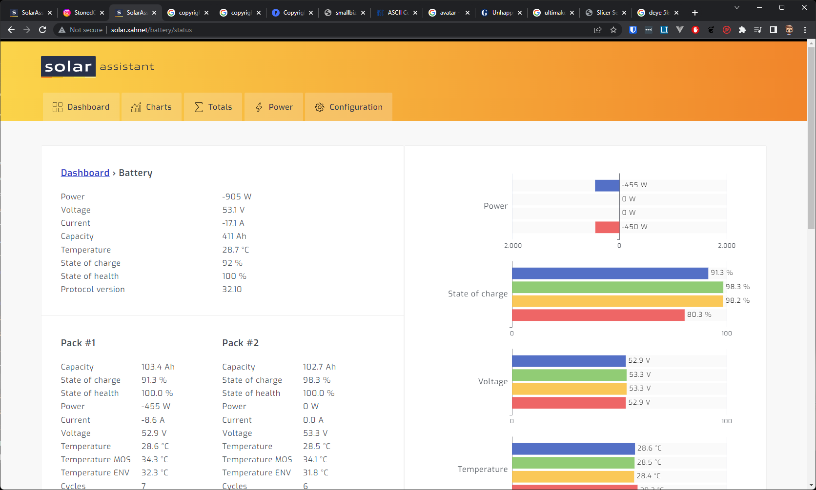

December 11, 20223 yr 8 minutes ago, jumper said: Looks like you have a mix-up between CAN and RS485 dip switch settings ok this makes sense then. I didn't know that there are differences in the dip switches for rs485 and can, so when CAN is setup then the inverter sees them all fine, but solar assistant only sees 3 and throws an error, and in the RS485 setup, CAN communication with the inverter doesn't work but it reports correctly in solar assistant. which makes sense now that you showed the different settings based on the comms that is used. Now just need to figure out if i can use RS485 for comms with Deye 5KW and shoto. in the documentation i saw that it only mentioned CAN Appreciated
December 11, 20223 yr 59 minutes ago, lemonxah said: ok this makes sense then. I didn't know that there are differences in the dip switches for rs485 and can, so when CAN is setup then the inverter sees them all fine, but solar assistant only sees 3 and throws an error, and in the RS485 setup, CAN communication with the inverter doesn't work but it reports correctly in solar assistant. which makes sense now that you showed the different settings based on the comms that is used. Now just need to figure out if i can use RS485 for comms with Deye 5KW and shoto. in the documentation i saw that it only mentioned CAN Appreciated No problem. Not 100% sure as I don't have SA, but is it possible to run the cable from the pi to the inverter instead of from the master battery to the inverter? I'm not sure if SA can pass the bms data on to the inverter.
December 11, 20223 yr 22 minutes ago, jumper said: No problem. Not 100% sure as I don't have SA, but is it possible to run the cable from the pi to the inverter instead of from the master battery to the inverter? I'm not sure if SA can pass the bms data on to the inverter. yeah i have the battery info on SA, i have another question related to the batteries. like last night power was being drained from all the batteries at the same time but today it looks different: is it normal for the system to only use 2 of them even though all of them are there? if i draw more power i can see the other 2 batteries contributing lik 20w each but nothing much

December 13, 20223 yr On 2022/12/11 at 2:02 PM, jumper said: Looks like you have a mix-up between CAN and RS485 dip switch settings... the dip switches for the last 3 batteries in the CAN setup is the same as the first 3 batteries in the RS485 setup, so your inverter is likely seeing batteries 2,3,4 as 1,2,3 and battery 1 is ignored. You should use the setup as per the RS485 doc attached for the seplos BMS as these batteries use this to communicate with each other. The CAN is only from the battery to the inverter. So, Bat1=dip 1, Bat2=dip2, Bat3=dip1&2, Bat4=dip3 RS485 DIP ADDRESS SETUP.pdf 31.4 kB · 2 downloads CAN DIP ADDRESS SETUP.pdf 35.59 kB · 2 downloads Thanks a lot jumper. I changed the dipswitches as you suggested and the battery bank went from 200ah to 50ah. Reverted.... What I just noticed on the luxpower web interface is that the primary inverter is BattParallelNum 4 and the 2 subordinates are BattParallelNum 0. See attached.
December 13, 20223 yr 39 minutes ago, Mark Shepherd said: Thanks a lot jumper. I changed the dipswitches as you suggested and the battery bank went from 200ah to 50ah. Reverted.... What I just noticed on the luxpower web interface is that the primary inverter is BattParallelNum 4 and the 2 subordinates are BattParallelNum 0. See attached. Sorry that didn't work. From the BattParallelNum values you have there it looks like there is an addressing problem which is exactly what the dip settings are for. Have you also been resetting the batteries when changing dip settings? The only suggestion I would have is to pull the comms cables between batteries and change the dip settings and then turn each battery off, reconnect the cables and then turn on the master battery first (turn the other batteries on one by one if they don't start automatically). If you did that then unfortunately I cant help any further... the manual is all I have to go by as far as paralleling is concerned.
December 13, 20223 yr 2 hours ago, jumper said: Sorry that didn't work. From the BattParallelNum values you have there it looks like there is an addressing problem which is exactly what the dip settings are for. Have you also been resetting the batteries when changing dip settings? The only suggestion I would have is to pull the comms cables between batteries and change the dip settings and then turn each battery off, reconnect the cables and then turn on the master battery first (turn the other batteries on one by one if they don't start automatically). If you did that then unfortunately I cant help any further... the manual is all I have to go by as far as paralleling is concerned. No, have not been resetting the batteries. Good idea. I will follow these instructions and let you know. Many Thanks

June 27, 20233 yr Hi, I’m still a bit confused about this. I’ve got a 5KW deye with 2 X 5.12 shoto’s. They installed it as follows B1 – CAN to inverter B1 – RS485B to B2 – RS485A (?????) Dipswitches B1 = 00001000 B2 = 10000000 I’ve got the RPI cable to the inverter and all is working well with the battery setting to “Use inverter values”. Cool, now I want to add the RPI battery cable and If I plug it into B1 – RS485A, I only see 1 packs values and the same if I plug it into B2 – RB485B From what I understand in this(https://powerforum.co.za/topic/10747-wiring-advise-deye-8k-inverter-2-shoto-512kwh-lifepo4/) posts answers is that B1 – RS485A should go to B2 – RS485B and from the current post that dip switches for B1 = 10000000 and B2 = 01000000. I then assume that the RPI cable should go to B1 – RS485B and I have to reset the battery packs with the inverter switched off(first B1 then B2 reset)? Any help will be appreciated
June 27, 20233 yr So why are you using the CAN connection? I have mine working as follows keep in mind I have 3 batteries Solar Assistant USB connected to serial port on the inverter then USB from Solar assistant to battery pack 2 on RS458A pack 1 RS458a via Ethernet to RS485b (pack 2) pack 3 RS458a connected to pack 1 on RS458b dip settings 1 on battery 1 up. dip setting 2 on battery 2 up. all dip settings on battery 3 down.
June 28, 20233 yr 21 hours ago, SJB said: B1 – RS485A should go to B2 – RS485B and from the current post that dip switches for B1 = 10000000 and B2 = 01000000. I then assume that the RPI cable should go to B1 – RS485B and I have to reset the battery packs with the inverter switched off(first B1 then B2 reset)? This should work as @Raiden2912has posted above, you just need to remove the CAN cable between the inverter and the battery and let the RPI do everything over RS485. There seems to be an issue with the seplos BMS where, if the dip switches are set up for CAN, then the RS485 network doesn't work because it has different dip switch settings. So basically you are setting the batteries dips to work on the RS485 network not CAN (you can't use both at the same time apparently).
June 28, 20233 yr thanks for the reply. I was under the impression that the deye needs to talk to the BMS, so I can remove the CAN cable? set the dip switches and I assume resetting the batteries will look like this now
