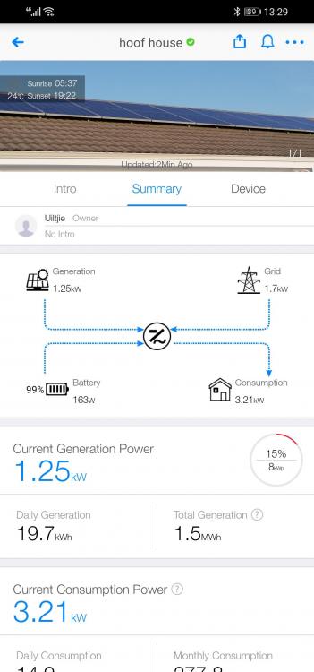

Weird Sunsynk Power usage
I've noticed that, every now and then (randomly), my 8kW Sunsynk is pulling a whack load from the grid, even though there is plenty of sunshine...
Any idea why this might happen?

Looking again at your energy purchased it appears very low so I do not see a problem; that 1.89 kwhr is what happened at that particular point in time so is not continuous. One would get a better picture of what is going on by looking at the graphs if you are using Solarman Smart from a computer screen

What size solar array do you have ? Either there is not more than 1,25kw solar available or you have the SOC set to 100? That would be my guess. Maybe some clouds rolled through ? Shading issues?
8kW roughly, no clouds, no shade, and the inverter settings are those in post 3, but have set the % lower as recommended.

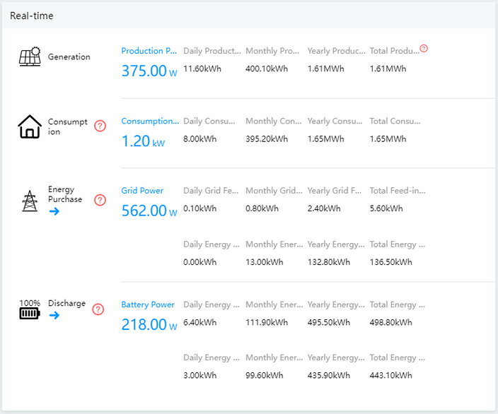

Adding some more screenshots:
Full sunshine during both "events"... nothing coming from the battery, only ever from he grid, even with a 100% battery.... 🙄
You said, you have  18 x 420W Canadian Solar panels. Then why are you producing only 375W during full sunshine?
edzachery... some proper weirdness here
This points to problems with the PV strings. I think, you should speak to your installer.
