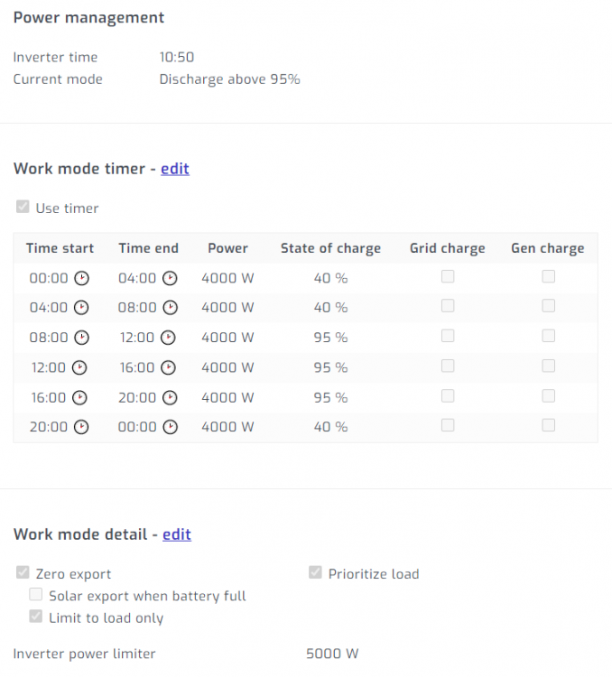

1 hour ago, Scubadude said:
That is great news as my installer only uses Deye and me a really great deal, so Sunsynk not presently an option. Also makes my decision of Wifi donlge/Solarman vs RS232-to-USB/Raspberry Pi/ SolarAssistant so much easier. I have an unused Pi 3 which will cope fine wirg running SolarAssistant. Any RSR232-USB cable can work, right? Initially I'll run Solarman on the supplied Wifi dongle, but longer term I'll definitely go the SolarAssistenat route. Planning to run a 10m cable to put the Pi where it is within easy reach of Wifi.  Or maybe just run an ethernet cable?
This is the Power Management tab on Solar Assistant.
Initially I bought the RS232 cable from Solar Assistant (https://solar-assistant.io/shop/products/sunsynk_rs232) but the serial connector itself was too thick and did not allow for plugging in to the Deye inverter.
Solar Assistant then said to purchase this cable from Takealot and I have not had any problems with it fitting into the Deye inverter (https://www.takealot.com/ce-link-usb-2-0-to-rs232-db9-serial-male-a-2m-cable/PLID51855970)
If you can run an ethernet cable to the Pi, that would be first prize.
MdF
