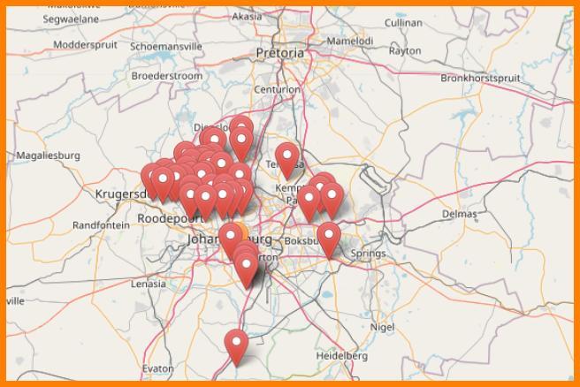

2 hours ago, PowerUser said:
Wow, this tool is such a big security risk for targeted robberies! It shows exact location to everyone to see!
How do you conclude that it's a risk for targeted robberies?
Will someone come and steal my PV panels?
The location information is voluntary.
If thieves want to target a home, they could use:
  • Driving around the suburbs.
  • Property Value information from Metro General Property Valuation Register
  • Property24.
  • Google Earth (Satellite) or other satellite site.
  • Bing Street View/Google Street View
1 hour ago, Scubadude said:
I would be interested to join. How do you interface your data?
There is a forum & help site that discusses how to upload data:
https://pvoutput.org/help/index.html
https://forum.pvoutput.org/
There are various methods - some involve push, some involve pull.
There are 2 API's one for daily and one for real time.
I think the "daily" one is legacy.
I used the "daily" api via "cURL" to upload the previous days readings as documented in the API
https://pvoutput.org/help/api_specification.html
