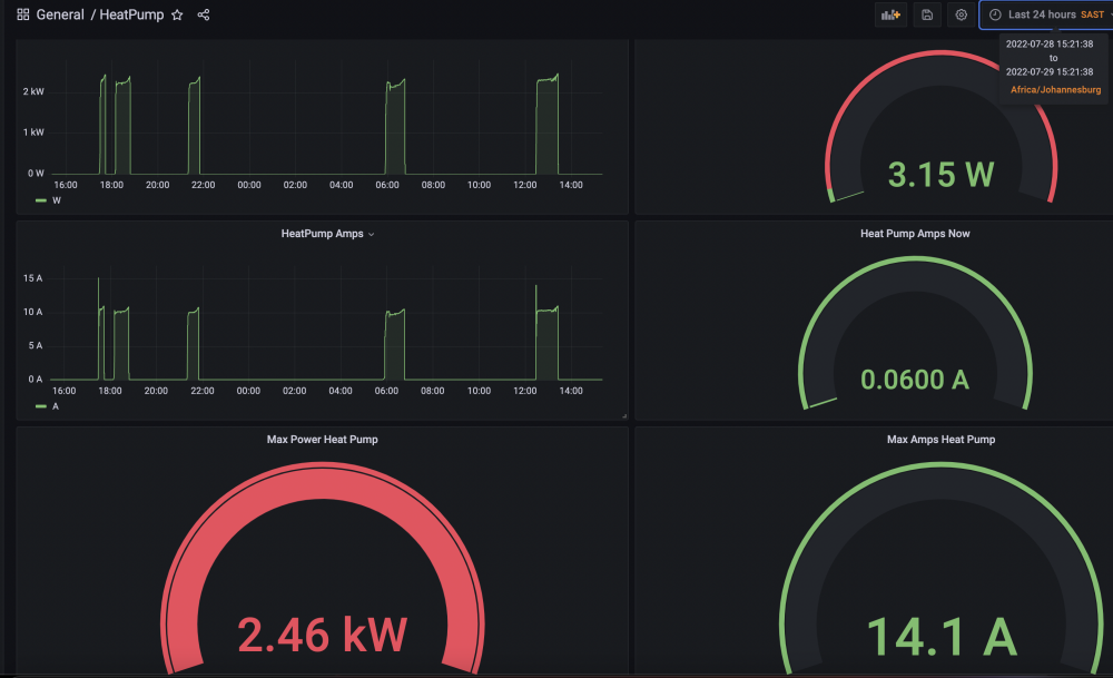

hi @Iiceman how many KWs does the 7.2kw unit pull ? I was looking at 5kw heatpump (Alliance) from AC direct they told me it uses about 1.3kw per hour which is not bad. So was wondering what the 7.2kw unit is on usage
Just now, Iiceman said:
@Treschen, those numbers are not entirely accurate, i have a sonoff pow R3 monitoring it, and it uses about 2.4Kw/h. Ive seen it jump to about 2.6Kw/h at times..
Thanks @IicemanI can live with 2.6kwh vs my current 4.4kw
