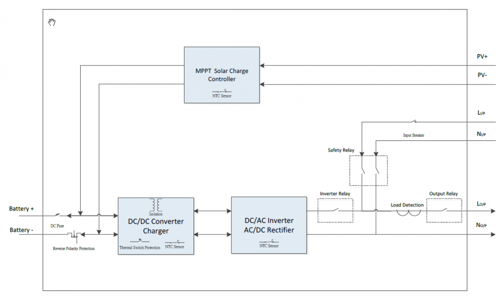

June 11, 20179 yr @Coulomb, apologies for summoning your expertise like this, but perhaps you can elaborate on the interlocking of the Axpert's changeover switch? In the Multi, I know it is designed such that it can close while the inverter is active, obviously because this is a hybrid. On the Axpert, could a bug in the software (for example) cause accidental backfeed if the transfer switch remains closed somehow? To be specific, I want to know if some effort was made to ensure mutual exclusion in the circuitry.
June 12, 20179 yr 8 hours ago, plonkster said: To be specific, I want to know if some effort was made to ensure mutual exclusion in the circuitry. In another thread @Chris Hobson mentioned that he may soon be getting his hands on a smoked Axpert, maybe Chris can have a close look at the bypass mechanism.
June 12, 20179 yr 15 hours ago, plonkster said: @Coulomb, apologies for summoning your expertise like this, but perhaps you can elaborate on the interlocking of the Axpert's changeover switch? In the Multi, I know it is designed such that it can close while the inverter is active, obviously because this is a hybrid. On the Axpert, could a bug in the software (for example) cause accidental backfeed if the transfer switch remains closed somehow? To be specific, I want to know if some effort was made to ensure mutual exclusion in the circuitry. The Axpert isn't grid-tie. It is physically impossible to back feed. The output is determined by a relay that switches the output live wire between either line or inverter. There is no direct circuitry allowing power to feed back into line from the inverter side. The only real safety concern for the Axpert inverter is if an earthing relay is not installed OR the earth relay fails. If the earth and neutral isn't bonded, there is no earth leakage protection and if anything became live in the installation you would electrocute yourself and the earth leakage wouldn't bat an eye. Alternatively if the earth and neutral are bonded permanently that is in direct contradiction to the SANS installation rules. By bonding permanently you created a new earth/neutral bond for everyone in your neighborhood. Because of this your neutral and earth wire will at that point become loaded with power from other houses. If the earth or neutral has a fault at the power transformer your neutral will melt down (eg. catch fire) because everyone will run over your neutral. In that sense the earth/neutral connection is the actual serious concern with that inverter. But there is 0 risk of back feed. It is a physical impossibility.

June 12, 20179 yr On 6/12/2017 at 7:17 AM, plonkster said: @Coulomb, ... perhaps you can elaborate on the interlocking of the Axpert's changeover switch? In the Multi, I know it is designed such that it can close while the inverter is active, obviously because this is a hybrid. On the Axpert, could a bug in the software (for example) cause accidental backfeed if the transfer switch remains closed somehow? To be specific, I want to know if some effort was made to ensure mutual exclusion in the circuitry. There are four relays on the Axpert, as per the attached diagram from one of the manuals. When AC charging (utility or generator), all four relays are on. So the inverter's "output" terminals are connected across the AC input. These are really input terminals when the inverter is configured in reverse. But like an AC motor controller in an electric vehicle, it is trivial to change the direction of power flow. In a vehicle, you can change from "motoring" (battery to motor load) or "regenerating" (motor/AC source to battery). The principle is the same whether the load is three phase or single phase. In my opinion, it is theoretically possible for the Axpert to push power into the AC "input". In fact, any inverter where the output can synchronised and connected to the mains can push power into the mains. It can't be avoided. If you want something that can't possibly push power to the mains, then you need a different architecture, like the 3 kVA models. See the second attached diagram. In this architecture, the inverter output is never connected to the mains. There is a completely separate charger for the purpose of charging the battery. A large charger becomes a significant cost, so why not use the inverter that is present anyway to do the charging? That seems to be the logic. So I have to respectfully disagree with @Gnome on this one; it's not physically impossible on the 5 kVA models to push power into the mains. Having said that, I've never seen the slightest suggestion that this ever actually happens. There may be "interlocks" in the software; that part of the firmware is very complex, and I haven't had a need to analyse it in detail. But whether there are or not, it's still "just software" and could theoretically go wrong and push power into the mains. The marketing of course suggests otherwise, but as far as I can tell, the attached diagrams show that it is possible.

June 13, 20179 yr I finally looked at the circuit diagrams in more detail. The 3kva should trivially pass, the relevant part marked in red, clearly showing a break before make changeover. Also... fixing the earth-neutral bonding on a 3kva should be really easy... The 5kva is physically capable of accidentally pushing into the grid, if something goes wrong and both relays are closed. As @Coulomb says, the interlock is probably in software.
June 13, 20179 yr How are those relays activated however? Interlocking relays typically have 2 methods to prevent a circuit being active simultaneously. The first is a simple circuit that prevents two relays being active at the same time. The coil wire of the relays are wired such that activating one relay makes it impossible for the other relay to be active at the same time. The second mechanism is a mechanical interlock. It isn't clear from this diagram wether the first is done or not. I would be surprised if they didn't do that because then as you say, it would become possible to back feed. It isn't typical to see this sort of device without that kind of protection. A simple arrangement in which this is possible for example is to place a transistor in the path of the ground of one of the relays. The transistor being activated by the other relay. Typical change over relays typically employ both of these techniques. The question is if SANS requires a mechanical interlock, which seems it does.
June 13, 20179 yr 19 minutes ago, Gnome said: It isn't clear from this diagram wether the first is done or not. I would be surprised if they didn't do that because then as you say, it would become possible to back feed. It isn't typical to see this sort of device without that kind of protection. I agree. More information is needed from someone with the hardware and the skills to follow the trace. I agree that it is relatively simple to interlock relays, but confirmation would be awesome. 19 minutes ago, Gnome said: The question is if SANS requires a mechanical interlock, which seems it does. Agreed, it seems it doesn't have to be a physical interlock. It need only be "suitably interlocking"... which is of course suitably vague as well :-)
