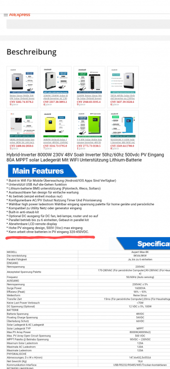

Look at this product description(8kw)
(In German )
There is an information that battery independent works for only for 320-450v solar input.
(In German )
Yeah it does say so, do you have personal experience on this?
Original Voltronic manual doesn't say anything on the Axpert MAX 8kw.
I have already ordered another 3 Panels going to 315-330 VOC from 205-215 i am now
