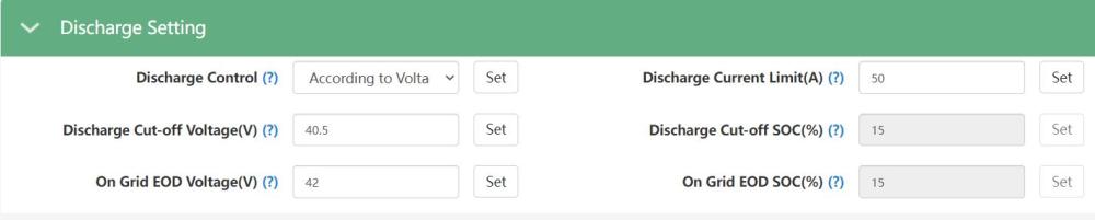

February 3, 20233 yr Greetings Roets Did you come right with the battery settings on the inverter. I am facing with same challenges. Luxpower SNA5000 inverter and 4.8 kw N Energy Lifepo4 battery . Attached find my current settings. Anyone with a solution? Thanking you in advance
