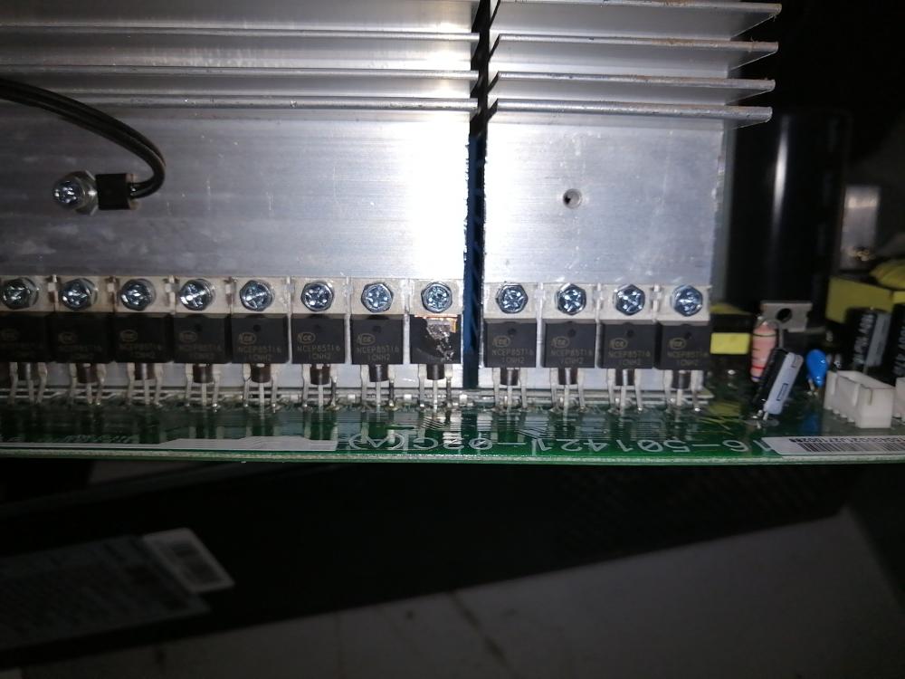

As of late, I have been seeing more and more inverters coming in with completely destroyed MOSFETs or IGBTs. Manufacturers keep saying it's user fault but at this consistency I can't help but wonder... Would they be using sub-par semiconductors because of the semi-conductor shortage or is it possible the South African Grid has become so unstable that its causing inverters to pop?
As you can imagine, there are a lot of very unhappy people asking for answers and all I can think is "Their power must be rubbish or they connected it wrong" because I cannot see it just happening... Any thoughts on the subject? Is this something thats super common and I just missed that thread?

I'm not familiar with the NCE brand. It could be that they are junk, I would not know. The datasheet says that they are 85 V 160 A parts.
The IGBTs pictured are ST brand, and are well-known good quality. If and when the MOSFETs short, that seems to send a surge through the transformer that tends to cause the IGBTs to fail.
The MOSFETs are protected against inductive spikes by the electrolytic capacitors nearby. That's why it is suggested that these capacitors be replaced with quality parts with a long rated life. Both my inverters have 100 V rated MOSFETs and 10 000 hour rated capacitors. It's possible that recent capacitors that they are using are junk. The shortages are probably not limited to semiconductors.

They make some MOSFETs with impressive specs. I'm sitting with one where the only suitable replacements I can find are SiCFETs. That said, it is dead and I cannot verify that the claimed specs are accurate...

My 2c on this is that voltronics in their design minimise on components, particularly the capacitors that protect the mosfets. They also, as Coulomb identifies, use low lifespan capacitors that cannot handle surges as well as they age. With the longer power cuts the capacitors are being worked more and thus age faster. When battery voltage is low (also more likely with long outages) the current through the mosfets will be higher and if there's a surge the capacitors don't handle it as well and hence you get increased chances of failure. Yes AC surges could be a contributing factor but personally I think the capacitors are more to blame than the semiconductors. As a last comment I have seen as many failures with international rectifier and other recognised manufacturers as I have NCE.
I cannot thank you all enough for the feedback! It's a pity that the only real fix is to change components inside of the unit, but there isn't much you can do with a badly designed product. I really appreciate y'all
