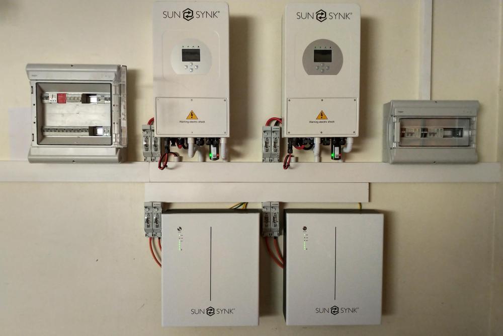

And it was installed last week. With all the rain and horrible weather since installation I was starting to doubt my sanity since the performance was dismal, apart from the lack of loadshedding at home, which was a huge plus but not at that expense. Yesterday I could at last start to smile given the clear skies and I generated 21.4kW with a peak of 4.8kw. I even ran out of things to consume all the "free" electricity so the total for the day could have been higher. Today is another glorious sunny day and the geyser is fully heated. I'm still tweaking settings as I go along and need to start looking at recording some proper real-time statistics. As nice as the Sunsynk app is (not really) I don't want to wait minutes to see the current figures.
There's also lots of niggles which I can't quite put my finger on which someone can maybe help me decipher:

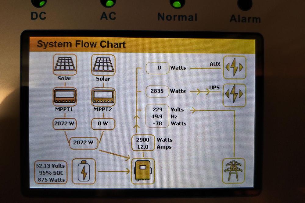

  1. Why does it appear as if it's feeding back into the grid (seeing negative readings on the slave unit at times). My installer only had a single CT coil plugged in on the master unit monitoring the feeding line between the main DB and the new DB and I changed that so I have a CT coil on both units on their individual feeing lines. And yes, the CT arrow does point in the right direction and it shows a positive reading when consuming from the grid. The master unit shows 0 when it's not using the grid.
    image.thumb.jpeg.6ab370c638e08131ef68eec9c2d6419f.jpegIMG_20230802_1447501.jpg.8b2496d140aaf1634ea4978add4f27f0.jpg
  2. Why does the inverters still use grid power? I'm seeing between 2.2 and 3.6A being drawn on the Clearline unit on the grid line. Since I have nothing on the non-essential side, I've set trickle usage to 0W. And yes, I've tried a trickle of 10W too, but I still see usage. So why are the inverters consuming grid power when there's ample battery available? If I drop the breaker for the incoming feed the Clearline unit shows 0A, so the inverters are definitely consuming grid power.

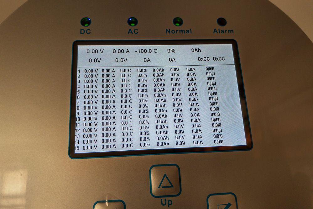

  4. I'm using a CAN connection between the master inverter and the first battery and a link cable between the batteries (link in, link out) and some (limited) battery information shows on the master. The slave inverter doesn't show any battery information. Is this correct or should I recheck the battery cables? I've used normal network cables for these connections but I'm unsure whether that's correct or not? Master on left, slave on right:
    masterslave
    IMG_20230802_1431114.jpg.9fe70dd9e485210c0b08e74a0b331882.jpgslave
The CT coils MUST/SHOULD be at your incoming live just after your municipal/eskom meter before anything else. This is usually at the entry point of your main db.
Also on the images of the screen you post it is not showing your home grid at all?
That trickle feed is quite important, the inverter is not quick enough to prevent power going back to the grid when loads switch off, that trickle feed helps mitigate that back-feed a bit. I have found 50watts to be a sweet spot on my setup.
Everything is on essential, so there's nothing before the inverters. So power from outside flows via the prepaid meter and then into the feed-in inverter breakers (and through the CT coils on that leg). Once past the inverters it flows via the outgoing breakers. Yes, I was breaker happy so I can isolate an inverter should one fail. My CT coils are on the individual feed-in inverter breakers, one CT coil per inverter.

Good looking install by the way, and nice to see you’ve got individual DC connectors/fuse links for each battery. I also went that route, and in fact, my two batteries go to a common busbar after the DC disconnectors, and then onward to inverter (one inverter).
I have a common battery busbar inside the trunking above the batteries as well. That way I can do 3 or 4 batteries in the future, should I want to in the future. A common busbar is a better solution in my opinion than to daisy chain the batteries.
    masterslave
