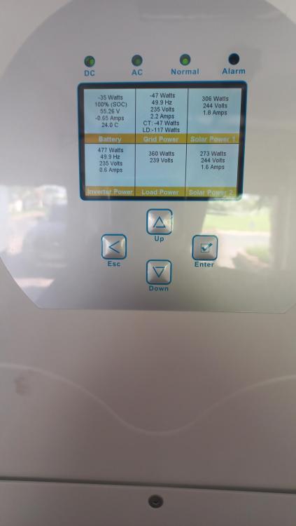

Donovanvdb Posted September 16, 2021 Author Share Posted September 16, 2021 Hi @Pumba here is a pic of the latest 5kw that I got 2 months ago Quote Link to comment Share on other sites More sharing options...
Pumba Posted September 16, 2021 Share Posted September 16, 2021 Strange, what you have in your pic at the bottom of your inverter I have on the top of mine, and when looking from underneath I can see the fan. Temps I gave you are for the DC inductor, and looking at my device graphs the max AC temp is about 45 to 48 deg when running at 2000 to 3000 watts from solar and the fan does not come on. And yes the inverter will trip if it over heats. Quote Link to comment Share on other sites More sharing options...

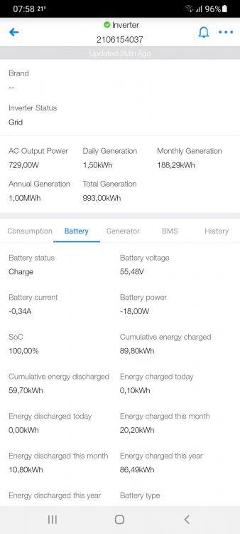

Convict Posted November 12, 2021 Share Posted November 12, 2021 In The app it says under temps Battery temp 23c And inductor temp2 -109.99c so somethings not right Quote Link to comment Share on other sites More sharing options...
PowerUser Posted November 12, 2021 Share Posted November 12, 2021 (edited) @Convict if you go under device - inverter and scroll down the page, you can see the inverter temperature. I have seen mine going over 56 deg while charging the battery but that shouldn’t be a problem. Edited November 12, 2021 by PowerUser Quote Link to comment Share on other sites More sharing options...
Convict Posted November 16, 2021 Share Posted November 16, 2021 Seems mine doesn't display Temps. Not sure if it's a fault or just how the new 5kva units are . Quote Link to comment Share on other sites More sharing options...
PowerUser Posted November 16, 2021 Share Posted November 16, 2021 8 minutes ago, Convict said: Seems mine doesn't display Temps. Not sure if it's a fault or just how the new 5kva units are . The screen you are showing here is from SolarmanPro App. You need to link it to SolarmanSMART App. That one will show you temp as described on the screen above. You can link the same inverter to both Apps. Quote Link to comment Share on other sites More sharing options...

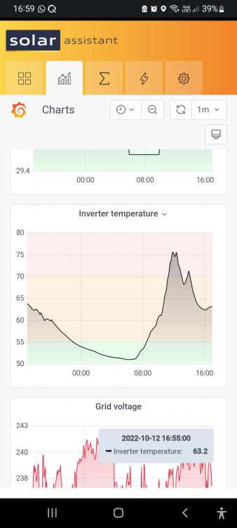

Terminal3k Posted October 12, 2022 Share Posted October 12, 2022 So my sunsynk 5kw inverter is getting up to 75 deg, can't hear any fan coming on.... Any suggestions? Quote Link to comment Share on other sites More sharing options...
PowerUser Posted October 12, 2022 Share Posted October 12, 2022 15 minutes ago, Terminal3k said: So my sunsynk 5kw inverter is getting up to 75 deg, can't hear any fan coming on.... Any suggestions? Do you know which temperature SA read? I have DC temp and AC temp in Solarman and they are different. Quote Link to comment Share on other sites More sharing options...
Terminal3k Posted October 12, 2022 Share Posted October 12, 2022 23 minutes ago, PowerUser said: Do you know which temperature SA read? I have DC temp and AC temp in Solarman and they are different. I checked the solarman temp compared to SA and SA is reporting the DC temperature... PowerUser 1 Quote Link to comment Share on other sites More sharing options...
PowerUser Posted October 12, 2022 Share Posted October 12, 2022 7 minutes ago, Terminal3k said: I checked the solarman temp compared to SA and SA is reporting the DC temperature... Mine is at 68 deg at the moment and I can definitely hear the fan going. Maybe yours is just too silent. Quote Link to comment Share on other sites More sharing options...
mzezman Posted October 12, 2022 Share Posted October 12, 2022 1 hour ago, Terminal3k said: So my sunsynk 5kw inverter is getting up to 75 deg, can't hear any fan coming on.... Any suggestions? Its going to blow up Its not ideal but it will keep going. I've resorted to putting a fan underneath mine and now temps don't go above 65 Quote Link to comment Share on other sites More sharing options...
Terminal3k Posted October 12, 2022 Share Posted October 12, 2022 2 minutes ago, mzezman said: Its going to blow up Its not ideal but it will keep going. I've resorted to putting a fan underneath mine and now temps don't go above 65 What fan do you use? Quote Link to comment Share on other sites More sharing options...
mzezman Posted October 12, 2022 Share Posted October 12, 2022 1 minute ago, Terminal3k said: What fan do you use? Bought this one from Makro https://www.makro.co.za/appliances/fans-heaters-air-coolers/fans/floor-fans/elektra-23-cm-floor-fan-/p/000000000000383947_EA Plugged the UsB fan into the Pi i have by the inverter and that runs 24/7. If it gets hotter I'll use the larger fan also Quote Link to comment Share on other sites More sharing options...
