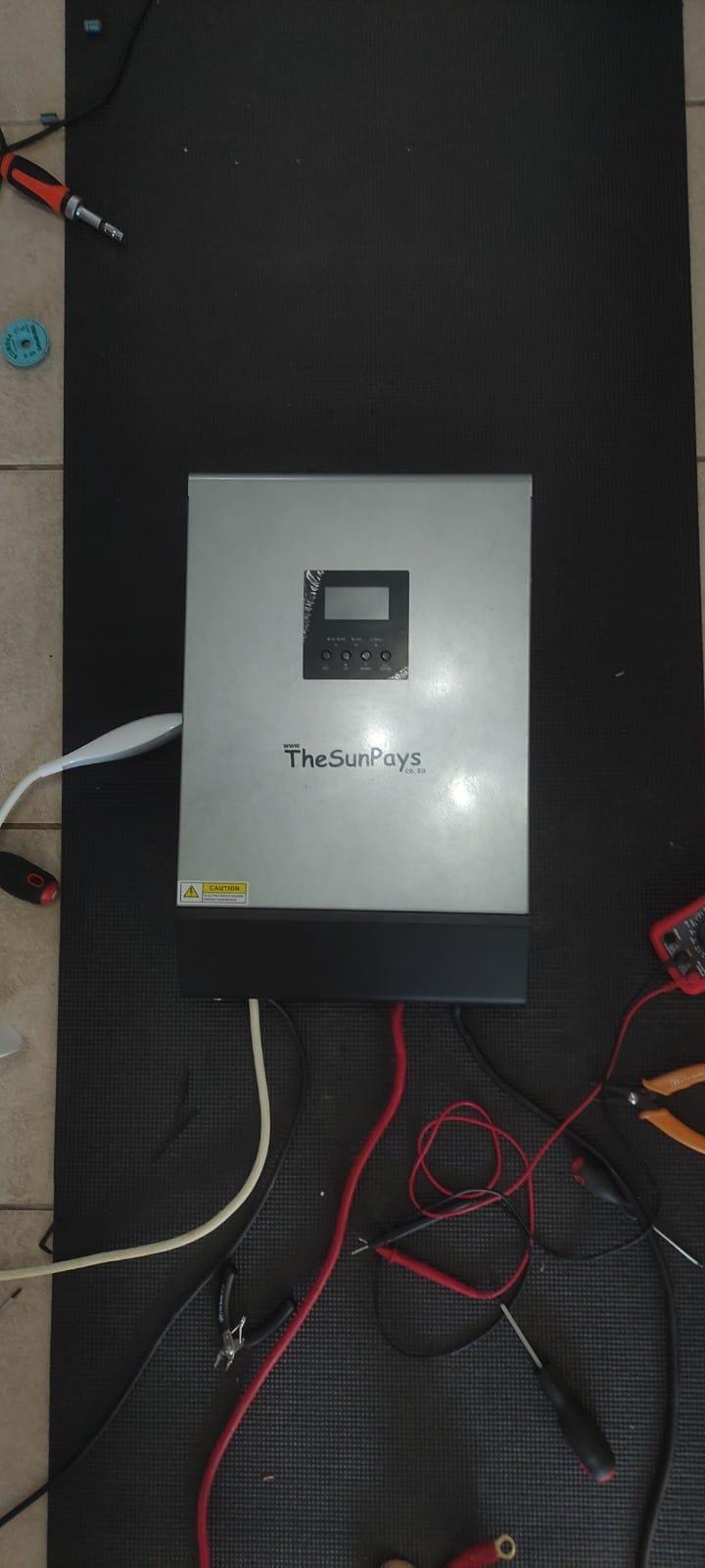

March 5, 20233 yr Hi PowerForum I decided to upgrade my battery setup from 8x lead acid 105Ah to a lithium unit. I disconnected and setup the Lithium battery (Dyness A48100), however on restarting the inverter all I hear is a clicking noise with all the lights flashing (incl screen backlight). The inverter never boots. The clicking noise sounds like a relay (clicks twice in a second). I have tried reconnecting the lead acid batteries but the same problem now persists. I have seen other installs with the exact same setup so compatibility doesn't seem to be the issue. Voltage is correct at the inverter terminals and the battery fuse is still intact. No obvious physical damage to other components (capacitors, fans etc) within the unit. Please let me know if you have any ideas of what could be wrong and potential fixes.

March 7, 20233 yr Author Congratulations @BritishRacingGreen and @Coulomb!!! Thanks for the advice. Bought a couple capacitors and got the local TV repair guys to do the replacement. Inverter back online for a few bucks. Hopefully other find this thread useful. It's a fairly easy disassemble and reassemble process (take pictures along the way). I can't comment on the actual capacitor replacement but the guys had it done in less than 10 minutes. Definitely worth giving this fix a shot if you are experiencing the same symptoms.
