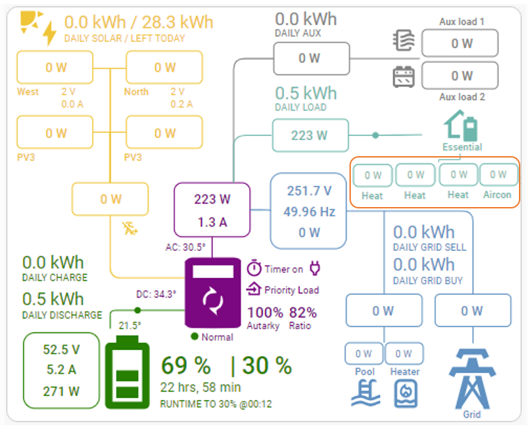

  • thank you @slipx, I've been using the power flow card for a while now but didn't know about the animations. now thanks your examples I've implemented the animations. I use a generator on my AUX port

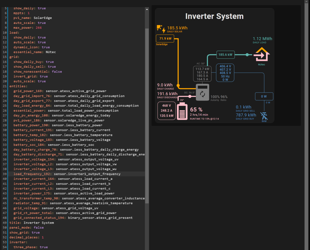

Not sure if this has been asked or addressed, but I am getting some strange behaviour on the card.
I have a 3 phase setup and using a combination of ATESS and SolarEdge inverters.
The issue I am picking up is that the output voltage values for the inverter display on the grid input section of the card.
Not sure if this is me being pedantic, but it is just a little strange.
There is also no option to include more than just a single grid voltage value.
There is also setion to include the grid frequency.
