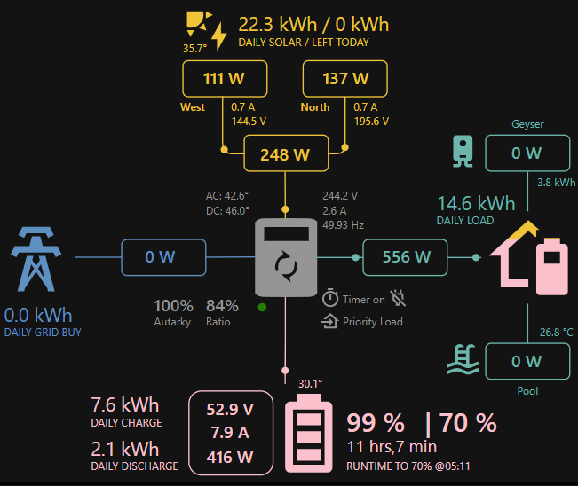

  • thank you @slipx, I've been using the power flow card for a while now but didn't know about the animations. now thanks your examples I've implemented the animations. I use a generator on my AUX port

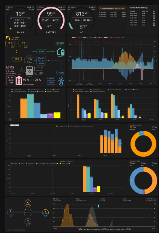

  • Here's a slight contribution to the goodness on this thread which lives on my main HA screen: type: custom:bar-card entities: - entity: sensor.load_shedding_area_eskde_4_sandownext10cityofj

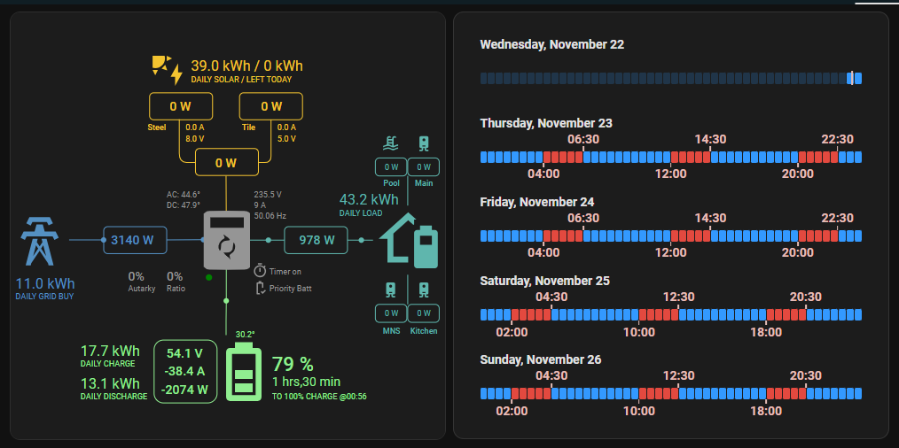

Hey @slipx
Quick Q: Are you able to share what the hex colour code is for the grid visuals?
(I'd like to match the blue with the blue on the load shedding schedule on the left)
Also, happy to share the code for this if anyone is interested :)
15 minutes ago, Deondup said:
@Muttley Yes please do share your code.
Can't take the credit for this.
See here: Link (assuming you have the Load Shedding by Wernerhp add-on already running)
You'll basically need:
  • His load shedding add-on
  • Lovelace HTML Jinja2 Template card - found in HACS front end
  • This code (with your loadshedding area):
(line 77 changes the colour of the blue bars)
type: custom:html-template-card
ignore_line_breaks: true
content: >
  {% set area_sensor =
  "sensor.load_shedding_area_eskde_4_sandownext10cityofjohannesburggauteng" %}
  {% set number_of_days = 5 %} {% set show_day_borders = false %} {% set
  show_end_times = true %} {% set timeslots = 48 %} <style>
      @media (prefers-color-scheme: light) {
          {% if show_day_borders %}
          .day_container {
              background-color: #fbeff3 !important;
          {% endif %}
          .current_time_indicator_text,
          .current_slot_indicator_start_text,
          .current_slot_indicator_end_text {
              color: #785551 !important;
          .current_time_indicator,
          .current_slot_indicator_start,
          .current_slot_indicator_end {
              background-color: #785551 !important;
          .slot {
              background-color: #66FF99 !important;
      .day_container {
          background-color: #2b2120;
          border-radius: 0.75rem;
          {% endif %}
          padding-top: 0.5rem;
          padding-bottom: 1.75rem;
          margin: 0.25rem 0;
      h3.day_heading,
          font-family: Roboto, Ubuntu, sans-serif;
          font-weight: 600;
      h3.day_heading {
          font-size: 1.0rem;
          margin: 0 0 0 1rem;
      .slot_container {
          display: grid;
          grid-template-columns: repeat({{ timeslots }}, 1fr);
          gap: 0.0725rem;
          width: calc(100% - 2rem);
          margin: 0 1rem;
          line-height: 0.9375rem;
          position: relative;
      .slot_container .slot:first-of-type {
          border-radius: 15%;
      .slot_container .slot:last-of-type {
          border-radius: 15%;
      .slot {
          border-radius: 15%;
          background-color: #3399FF;
      .active_slot_stage_1 {
          background-color: #f6a829 !important;
      .active_slot_stage_2 {
          background-color: #f8980d !important;
      .active_slot_stage_3 {
          background-color: #e66e0e !important;
      .active_slot_stage_4 {
          background-color: #e3493f !important;
      .active_slot_stage_5 {
          background-color: #d93e3d !important;
      .active_slot_stage_6 {
          background-color: #cf3131 !important;
      .active_slot_stage_7 {
          background-color: #b21e1d !important;
      .active_slot_stage_8 {
          background-color: black !important;
      div.active_slot {
          background-color: black;
      div.fade_slot {
          opacity:0.2;
      .current_time_indicator {
          width: 0.125rem;
          position: absolute;
          height: 120%;
          top: -10%;
          border-radius: 15%;
          transform: translate(-50%, 0);
          background-color: #e6bdb7;
      .current_time_indicator_text {
          position: absolute;
          bottom: 140%;
          color: #e6bdb7;
      .current_slot_indicator_start {
          width: 0.125rem;
          position: absolute;
          height: 40%;
          top: 100%;
          border-radius: 15%;
      .current_slot_indicator_start_text {
          position: absolute;
          top: 150%;
          color: #e6bdb7;
          width: 0.125rem;
          position: absolute;
          height: 40%;
          bottom: 100%;
          border-radius: 15%;
          position: absolute;
          bottom: 150%;
          color: #e6bdb7;
  </style> {% set area_schedule = state_attr(area_sensor, "forecast") %} {% if
  area_schedule is none %}{% set area_schedule = [] %}{% endif %} {% for
  day_offset_idx in range(number_of_days) %}
      {% set today_datetime_midnight = now().replace(hour=0,minute=0,second=0,microsecond=0) + timedelta(days=day_offset_idx) %}
      <div class="day_container">
          <h3 class="day_heading"
              style="{% if day_offset_idx == 0 or show_end_times %} margin-bottom: 1.5rem;
                  {% else %} margin-bottom: 0.5rem;
                  {% endif %}">{{ today_datetime_midnight.strftime("%A, %B %-d") }}</h3>
          <div class="slot_container">
              {% set ns = namespace(active_class_name="", last_slot_was_active=false, current_slot_was_activated=false) %}
              {% for half_hour_time_slot_idx in range(timeslots) %}
                  {% set half_hour_time_slot = today_datetime_midnight + timedelta(minutes=30*half_hour_time_slot_idx) %}
                  {% set ns.active_class_name = "" %}
                  {% set ns.current_slot_was_activated = false %}
                  {% for loadshedding in area_schedule %}
                      {% if not ns.current_slot_was_activated %}
                          {% if loadshedding["start_time"] <= half_hour_time_slot < loadshedding["end_time"] %}
                              {% if not ns.last_slot_was_active %}
                                  {% set percentage_of_region = (half_hour_time_slot_idx/timeslots)*100 %}
                                  <span class="current_slot_indicator_start" style="left:{{ percentage_of_region }}%">&nbsp;</span>
                                  <span class="current_slot_indicator_start_text" style="left:{{ percentage_of_region }}%;
                                              {% if half_hour_time_slot.hour == 0 %}transform: none;{% elif half_hour_time_slot.hour == 23 %}transform: translate(-100%,0);{% endif %}">{{ half_hour_time_slot.strftime("%H:%M") }}</span>
                              {% endif %}
                              {% set ns.current_slot_was_activated = true %}
                              {% set ns.last_slot_was_active = true %}
                              {% set ns.active_class_name = "active_slot active_slot_" + loadshedding['stage']|lower|replace(' ','_') %}
                          {% endif %}
                      {% endif %}
                  {% endfor %}
                      {% if show_end_times and ns.last_slot_was_active %}
                          <span class="current_slot_indicator_end"
                          <span class="current_slot_indicator_end_text"
                      {% endif %}
                      {% set ns.last_slot_was_active = false %}
                  {% endif %}
                  <div class="slot {% if now() > half_hour_time_slot + timedelta(minutes=30) %}fade_slot{% endif %} {{ ns.active_class_name }}">&nbsp;</div>
              {% endfor %}
              {% if day_offset_idx == 0 %}
                  {% set current_time_indicator_progress = now().hour*2 + now().minute/30 %}
                  {% set percentage_of_region = (current_time_indicator_progress/timeslots)*100 %}
                  <span class="current_time_indicator"
                  {% if not show_end_times %}
                    <span class="current_time_indicator_text"
                        style="left:{{ percentage_of_region }}%">Now</span>
                  {% endif %}
              {% endif %}
          </div>
      </div>
  {% endfor %}
