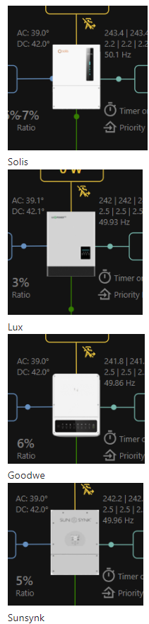

On 2023/11/12 at 8:46 PM, slipx said:
v3.13.0
🚀 Exciting New Features
- feat: add inverter images based on model. Set `modern: false` to enable
I don't see the modern:false line in the code? Am I missing something?
15 hours ago, Muttley said:
See last line:
Aah, changed it but no image of my inverter shows?

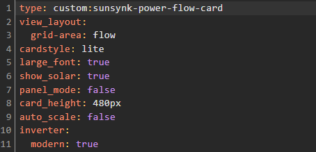

If you want to display an image of your inverter you need to set both the model and modern attributes. The modern attribute must be set to false. The image will change based on the model specified i.e. lux, goodwe, solis etc Remember this also affects the expected inverter status codes and messages displayed based on those codes.
inverter:
  modern: false
  colour: grey
  three_phase: true
  auto_scale: true
  model: lux
Edited by slipx

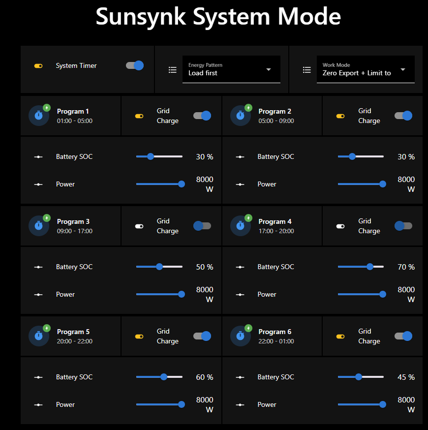

I was wondering if it would be possible to add a slider on your inverter control card to adjust the Battery Charge Amps:
Thanks as always!
What is the size of your fuse isolator on the battery ?
On 2023/11/17 at 5:58 PM, Muttley said:
Hey @slipx
I hope you're well :)
Thanks as always!
Hi. Are you referring to this one?
OK you could add like so

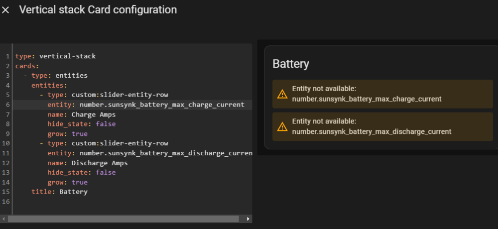

  - type: entities
    entities:
      - type: custom:slider-entity-row
        entity: number.sunsynk_battery_max_charge_current
        hide_state: false
        grow: true
        entity: number.sunsynk_battery_max_discharge_current
        hide_state: false
        grow: true
    title: Battery
        hide_state: false
        grow: true
    title: Battery
Thanks so much - just getting stuck on the creation of the new entities/template sensor:
Those sensors come from the registers below. BTW I made a bunch of updates to my ESPHome config. You can grab the latest version here
  - platform: modbus_controller         # 210 Battery Max Charge current
    use_write_multiple: true
    modbus_controller_id: inverter
    name: "${friendly_name} Battery Max Charge current"
    unit_of_measurement: "A"
    address: 210
    min_value: 0
    max_value: 185
    step: 5
    value_type: U_WORD
  - platform: modbus_controller         # 211 Battery Max Discharge current
    name: "${friendly_name} Battery Max Discharge current"
    address: 211
    min_value: 0
    max_value: 185
    step: 5
    value_type: U_WORD
    address: 210
    min_value: 0
    max_value: 185
    step: 5
    value_type: U_WORD
    address: 211
    min_value: 0
    max_value: 185
    step: 5
    value_type: U_WORD
Thank you so much as always - I really appreciate it!
