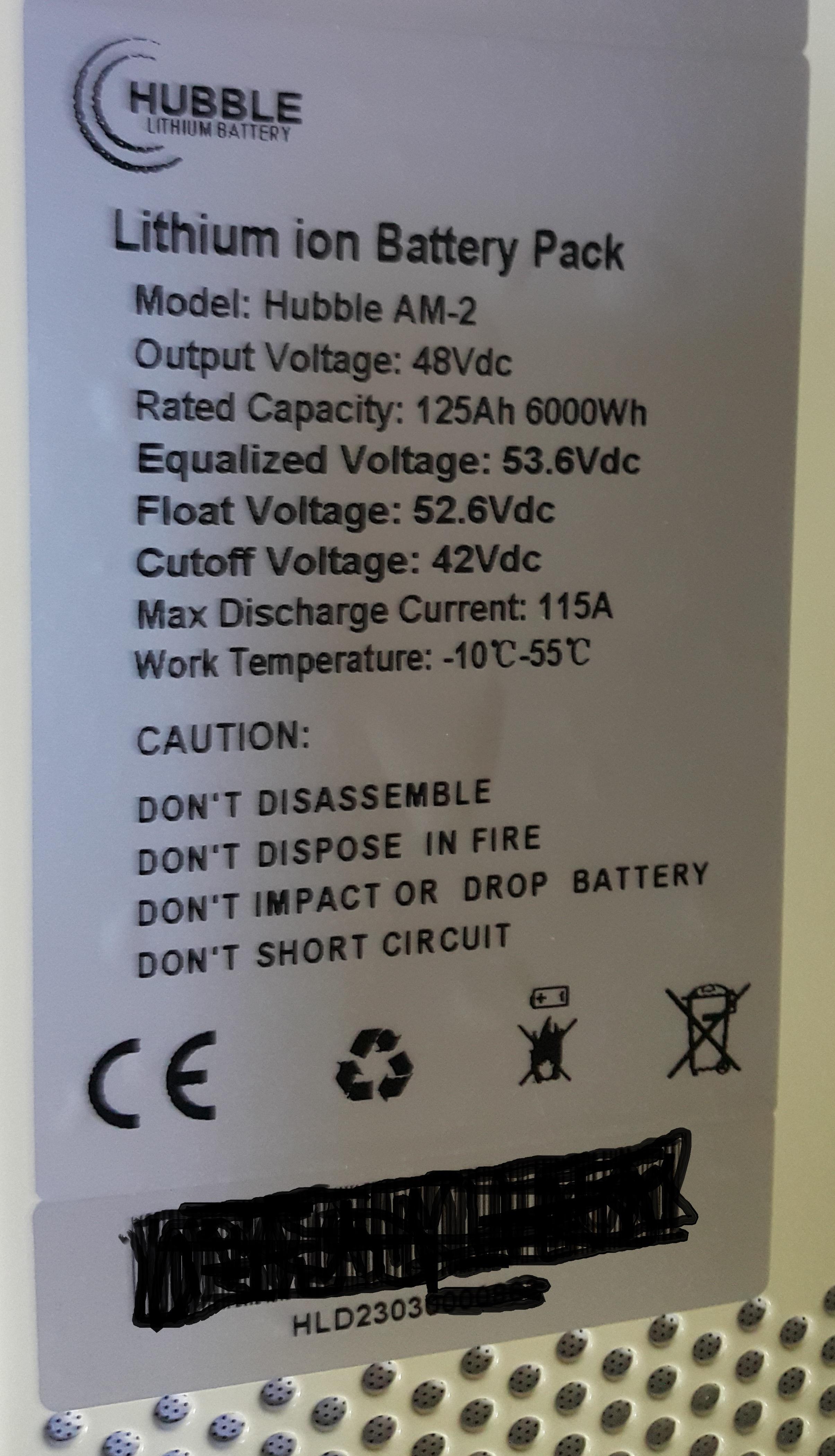

Oh, and as for lithium batteries running a geyser element or heat pump, a friend of mine just bought a new Hubble AM-2 today with updated spec's of 6kW, i.e 125Ah for a little over R28 000.
This is his fourth AM-2, and his geyser runs happily on battery and/or solar.

Off topic; @TimCam where did your friend buy the Hubble AM2 for that price? I was quoted R 31k for the 5kWh model.
Cheapest I can find is R 30k at https://www.inverter-warehouse.co.za/products/hubble-am-2-5-5kwh-lithium-battery-1?variant=43525702189305&currency=ZAR&utm_medium=product_sync&utm_source=google&utm_content=sag_organic&utm_campaign=sag_organic&gclid=EAIaIQobChMI7ezbpqS0_gIV0u3tCh1RmgjOEAQYASABEgKrgfD_BwE
