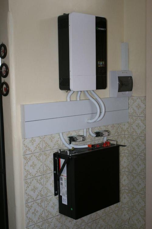

April 23, 20233 yr Rather try save up a tiny bit more and get the growatt as above The changeover switch and breakers and a bit of cabling should be about another R2k and then diy it This install was R45k including the CoC Edited April 23, 20233 yr by WannabeSolarSparky
April 23, 20233 yr Author Thanks WannabeSolarsparky 👍 That setup is neat, out of interest what website are those items from? Thanks Edited April 23, 20233 yr by Crazi098
April 24, 20233 yr 13 hours ago, Crazi098 said: Thanks WannabeSolarsparky 👍 That setup is neat, out of interest what website are those items from? Thanks That is my own photos not from the internet. Those prices are my prices I charge. Edited April 24, 20233 yr by WannabeSolarSparky
