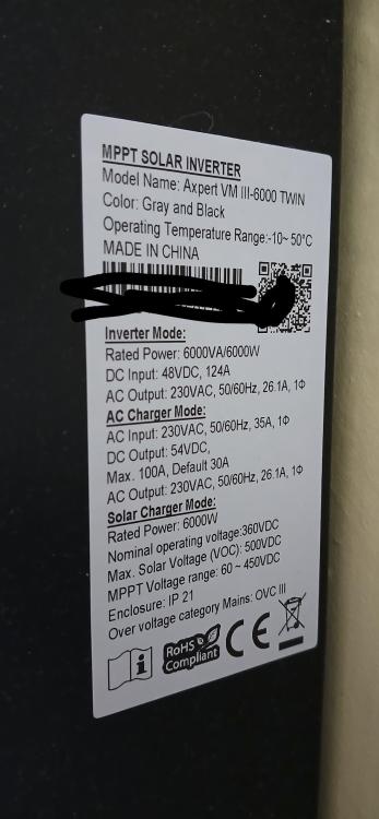

I have updated my MPP Solar 6048MT (I believe it's Axpert VM III 6KVA) to 60.05 firmware.
It seems that MPPT algorithm is a little bit better on cloudy days than my previous version 56.97, but still far from perfect.
There is a new bug, it seems that I can't increase "L2 turn-off battery voltage " above 45.9V. It was working on previous firmware.]
Maybe someone else can check?

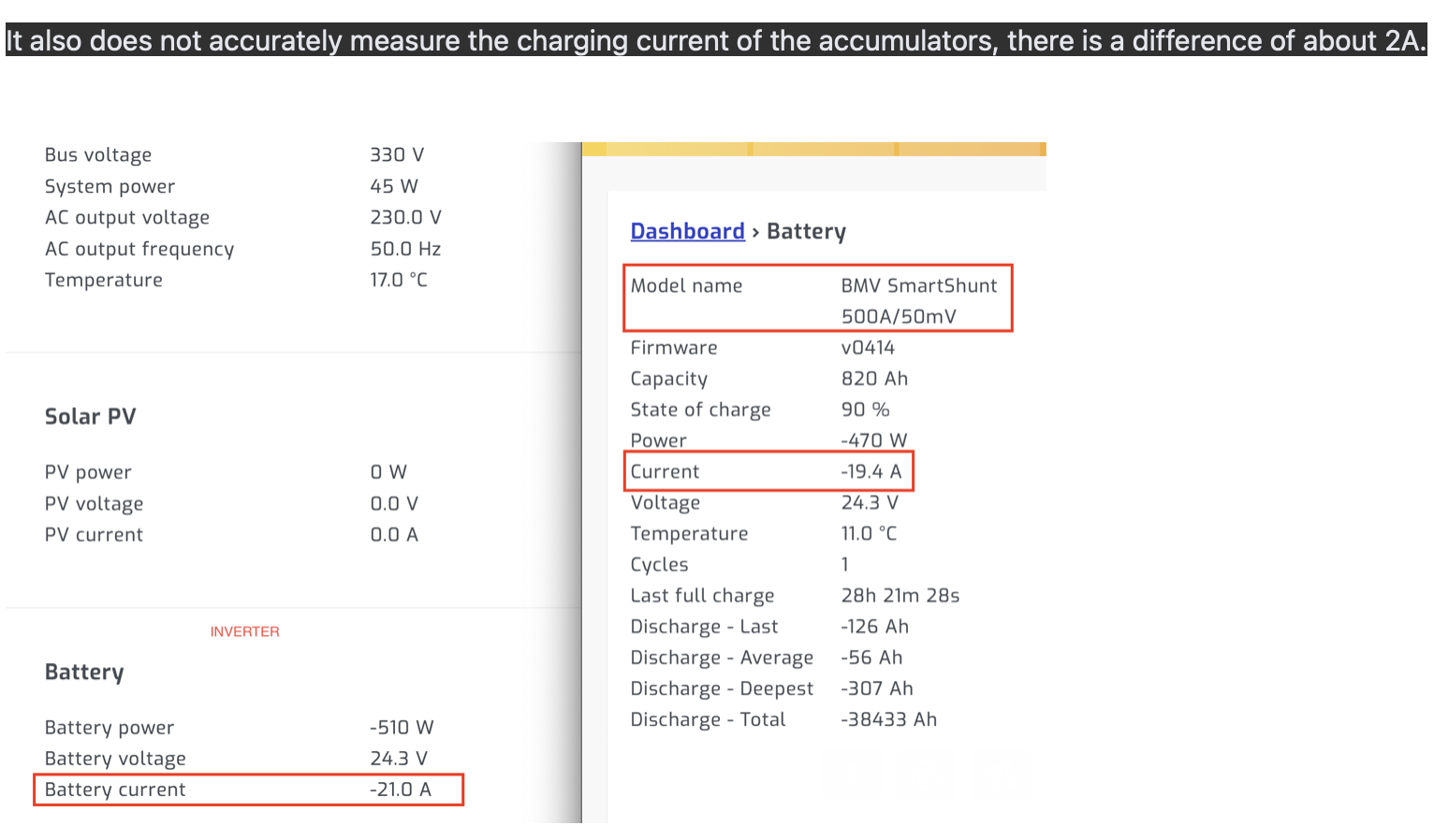

Hello.
I have an MPPSolár 4024MT inverter, (Axpert VM III Twin 4Kw)
It measured the current of the grid in incorrectly and when it switched to the bypass mode, it charged the battery with a constant 4A if voltage appeared on the PV input, even though the grid charging was disabled.
I received a new firmware for this from MPPSolár, which has been fixed.
But he has some problems.
It measures the current of the battery incorrectly, with a difference of 2A, and still charges the battery from the grid by 1-2 A
other than that it works fine.
VM_III_Twin_60_89.zip

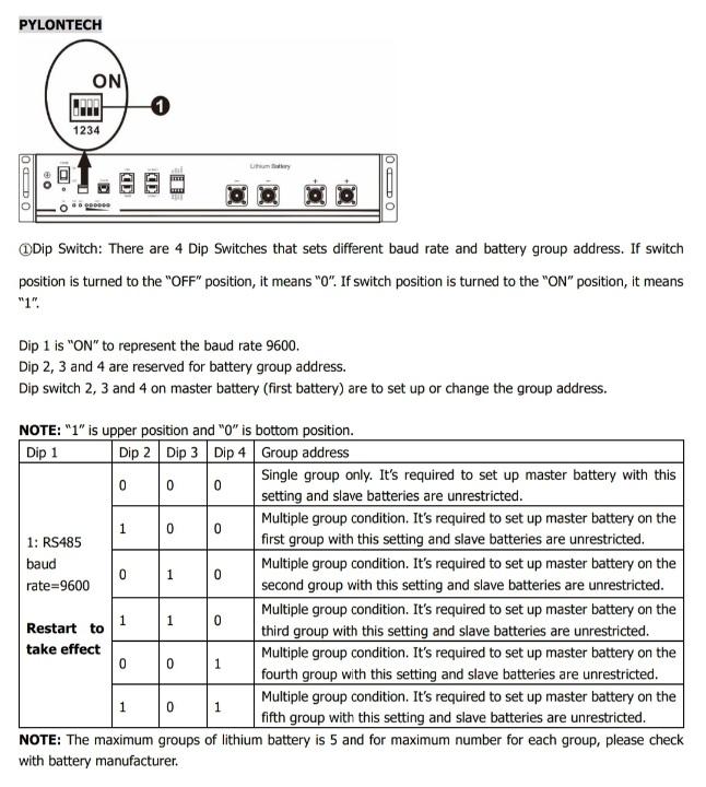

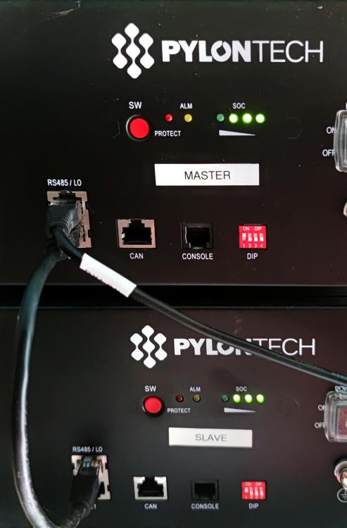

There is also on this forum 60.06 firmware patched by Coulomb.
or in topic
Quote
Force MPPSolar (Voltronic) bulk and float voltages for connected Pylontech battery
firmware 60.66 that fixes charging from the grid .
But I do not know if it is better than yours.

Weird, so they reintroduced this wrong behavior? My (much older) 60.66 firmware made it fully stop charging from grid if "Only solar" is selected
