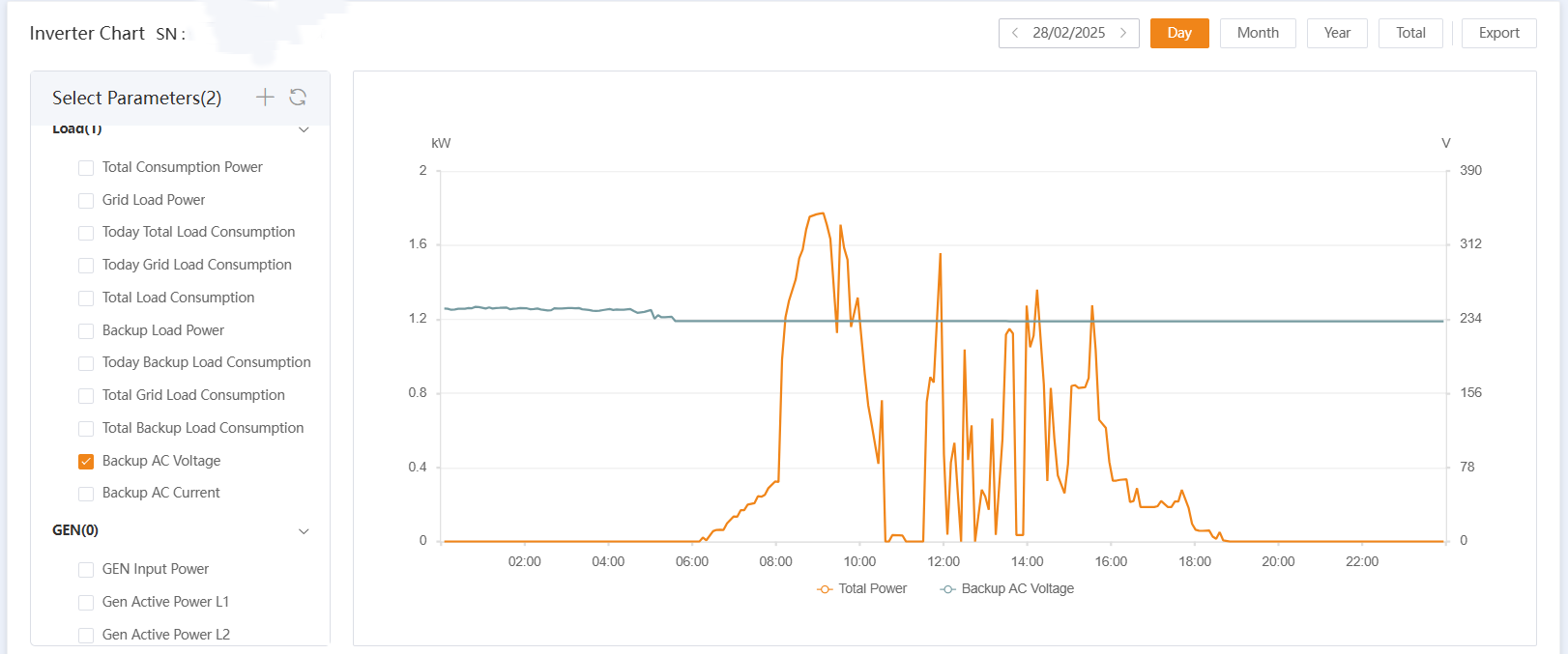

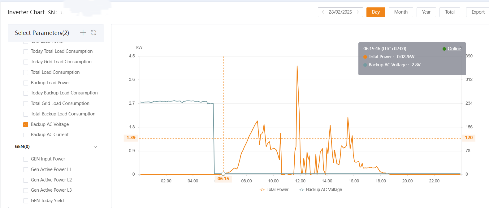

We have 3 different sites that are using 3 x solis (EH1P5K) and 3 BSL powerline-5(configured as a 3 phase system). We have had issues with these sites from the start. There was communication issues between inverters and batteries. related to firmware on both inverters and batteries. this has now been resolved.
The major issue that is not solved yet is the backup voltage on one phase just turns off. We have noticed its typically the L2 phase(in our 3 phase system).
This seems to be triggered by a grid supply issue of either over voltage or under voltage(when only on one inverter). The strange thing is that if the grid turns off completely the unit operates as it should.
This is a big issue and should the client have 3 phase loads, damage is very lightly without the correct protection.
We have moved away from Solis because of these issues.

I might be missing something vital, since I am not too familiar with 3P. But what would a different brand accomplish, if it's related to the grid? From my understanding, it does what it needs to do?

@Pho3niX90 a different brand may have a firmware solution to mitigate this grid issue.
The phase specific backup voltage dropout observed during partial grid disturbances e.g., over or under voltage on one phase is a standard protective feature in hybrid inverters from virtually all major brands.
High end models from Solis, Deye, Sunsynk, Growatt, Victron, SMA, and others monitor grid parameters per phase to ensure safety, compliance with local standards such as NRS 097 in South Africa, and protection of connected equipment. In grid referenced hybrid backup mode, an anomaly on a single phase typically results in isolation or shutdown of the affected phase.
A complete grid blackout transitions the system to off grid operation, where the inverters generate a stable internal reference, allowing normal function.
This response to grid conditions is an industry wide design characteristic rather than an issue isolated to any one brand.
For sites requiring reliable 3 phase backup particularly where load imbalance, grid instability, or three phase equipment are present a native 3 phase hybrid inverter, such as the Solis S6-EH3P15K-LV or equivalent models from other reputable brands, is generally more appropriate. Native 3 phase units offer inherent support for unbalanced loads across phases, simplified synchronization, and typically lower installation complexity fewer cables, fuses, breakers, and potential efficiency losses compared to paralleling multiple single phase inverters to achieve a 3 phase configuration.
System performance is influenced by numerous factors beyond the inverter itself, including Grid quality and stability from the utility e.g., voltage fluctuations, phase balance.
Site conditions e.g., earthing integrity, wiring quality, load distribution.
Correct hardware selection for the specific application and environment.
Installer knowledge and experience in configuration, parameter tuning, grid ride through settings, and matching equipment to site requirements.
Challenges in any installation often stem from these variables rather than inherent shortcomings in the product.
Selecting the most suitable hardware and ensuring professional, application appropriate installation are key to achieving reliable outcomes, regardless of brand.
