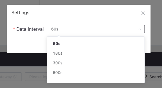

Slight deviation from the topic, by default the refresh rate on the App is 5min, you can change this to 60sec. if you haven't already done so...
Complete the form on this site -https://www.sunsynk.org/remote-monitoring- request Advanced User access, it will then give you the option to update the refresh rate to 60sec which will be able to do via the website under Equipment > Gateway > ellipses on the logger > Settings and then it will give this - see pic . Takes a few hours for them to action - you also won't know as I didnt get a notification but I just signed into the site the next day and had the option.
If you have manager access is this the same as advanced user?
Nope, Manager doesn't give you the lower time-refresh rate,
You have to fill in the form and you'll see the 60s option then appears (without any change to the 'role permission' for your user); took a day for me. Love the change, should be rolled out to everyone!

got my access changed to advanced, cant find the refresh rate though?
Need to do this via the website not the app - https://sunsynk.net/ - login here same credentials as the app.
Then 👇
