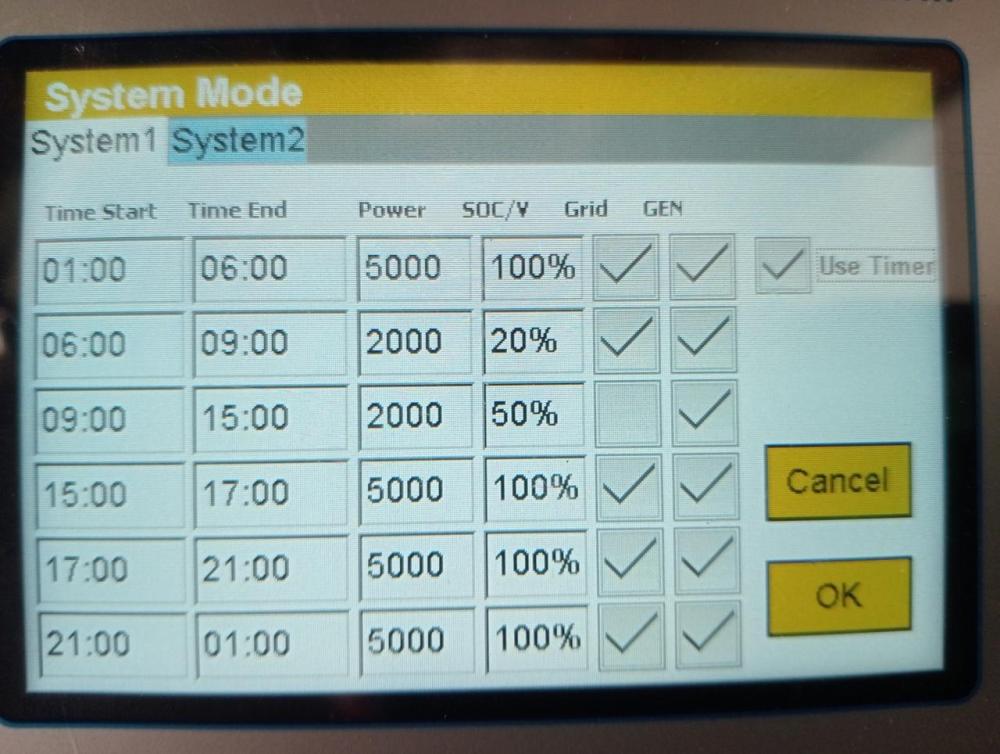

I will go take a picture of the settings but my understanding is that we have the inverter set to use the battery and obviously solar during the day and I did an exercise where I checked our meter at 6am then again at 6pm then again at 6am the next day and  between 18:00 and 6 am we used 18 units and between 6 and 18 when solar should be giving me the most we used 29 units which doesnt make any sense, generally at night we have about 3 TVs going my sons xbox fans in each of the rooms and all the lights. During the day I have my PC on and perhaps 1 tv??

Sounds like a settings on the inverter, specifically the System Mode Settings as this dictates the way in which PV, Battery and Grid gets used. So take pics of System 1 and System 2 from the Inverter.

As you have the battery at 100% at 6h I would do timer setting changes. Being at 100% no work for PV apart from your load.
6-9h-70% no grid
21-01h-70% grid
1-6h-40% grid
This will allow battery to provide some assistance.
OK setting s changed, can I ask what the power column is for why is it at 2000 for 6-9 and 9 -15?
I stand to be corrected on this one, but the Power limit set here is the maximum power it will draw from your battery to supply your essentials load.
OK so panels are Canadian solar hiku mono perc solar panel 450w
I guess this explains your higher grid usage...so each of the time slots that are set to 100% with Grid Ticked means the Grid will charge your battery back to 100%.
Example, say you have 2hrs of LS between 17:00 - 21:00, and it depletes the battery to 50%, when the Grid restores its going to charge the battery back to 100%.
If LS during the after-sun hours then your load will be fed by the grid...

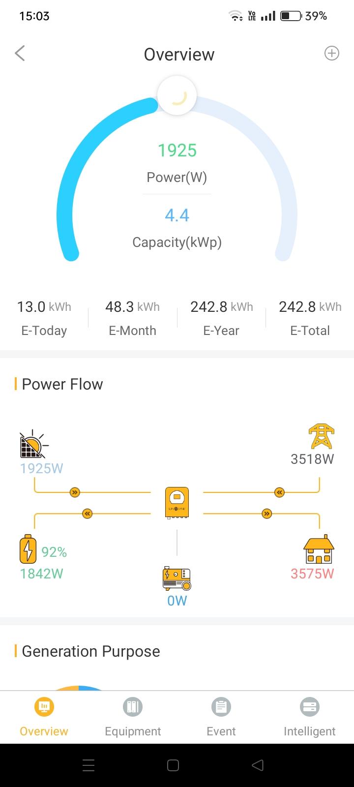

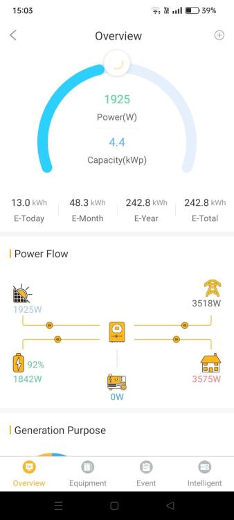

hey Carl, you are right we do about 2880w during midday I have seen it higher. The need for the system is both. I mean load shedding has dropped a bit and I need the system to lower my cost to eskom/ethekewini so a balance I guess. I can download the data export and send that through if it would help?

this is where we are now, my wife has the stove on so that would explain the high load right now..
