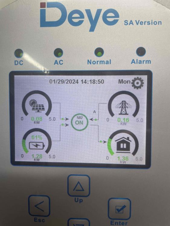

So took these pictures - not sure if they hold any clues. I have no idea what all the abbreviations mean. First one is the master, showing the 10W it is set at. Second the slave, also set at 10W but using 250W plus non-stop from the grid.

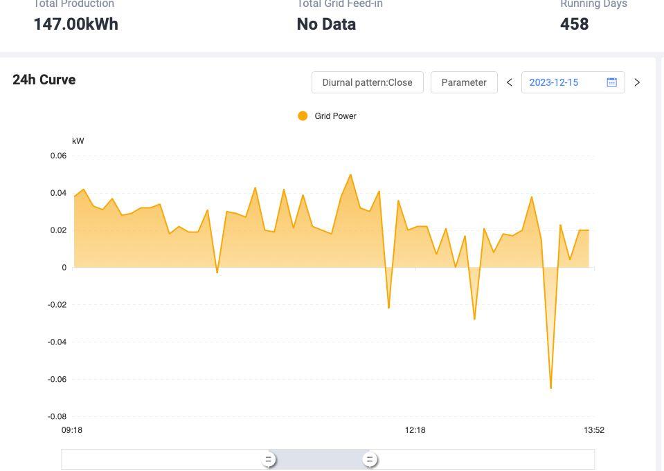

Looking at that graph, it seems like you are exporting, and as most meters are configured, you will be paying for that export the same as import. The fact that the grid power is measuring 0 means something is mis-configured/wired incorrectly.
Thank you. The system has been in for almost 2 years. Up to the Master been replaced in Jan, it worked perfectly. I am not aware of any system changes or setting changes, I never touch those myself. So from original installation to replacement of unit I ave about 3units a day (on whatever the settings was), then when unit was replaced it went up to around 8 (with supplier checking on three different occasions that the settings where the same as before). The suddenly 10 days ago (without me being aware of anybody changing anything - definitely not on site) the stats went crazy for actual usage as well as grid power, with me now using 17 units a day.
Below is a graph on the day it happened
For example it is not possible for me to use less than 700w at night as I have a oxygen unit running 24/7 for my mom that draws 620W
So it might very well be setting related, but I have not changed anything and those who have had a look recon all are set correctly - hence my request for some expert to come have a look

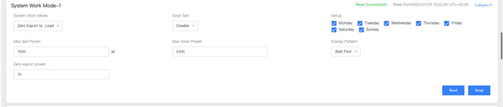

Try the following.
- Set the energy pattern to "Load First" and not "Battery First." Descriptions above don't sound right.
- Let your first time slot of the day start at 00:00.
- Can you try to show a SolarMAN graph of grid power, SOC and battery power on one screen. Wondering whether the grid-charge slots during the evening are interfering with drawing power from battery.
- Long shot, just speculation, wondering what type of PV voltage you are seeing from the panels at night.
- Call a real expert.
So I have set it to load first - it was on battery first. Also took 2 pictures just now of some settings - as well as what the dials are showing. Notice no usage in house - totally wrong, many things running, should be around 2kw+. Both investors shows the same - zero for house

4 minutes ago, JacoG said:
Also what @GreenFields said try to change it to battery first and check if this helps.
No, that's not what I'm saying. I'm saying to change it to Load priority. That means that the Solar power will go to the load first, and what's left will be diverted to the battery. If you've got the Battery Priority, then the solar will be diverted to the battery as first priority, and any excess power demand will be drawn from the grid.
It doesn't work like the SUB or SBU etc priority settings on the Axpert inverters where you select the order of priority of the energy source to supply load. Here you're selecting the order of priority of the energy demand.

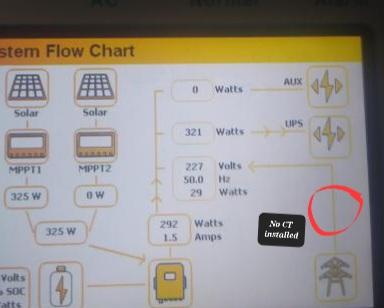

Agree fully. I suppose they get away with it because the system does function, and unless you really look into the detail of what is happening then most wont pick it up. I now for the first time have a true view of actual usage and my stats makes sense, compared to the meter stats. Even before all of this started there was a miss match between what the stats said I used as "Power Purchased" compared to what the actual meter reading was. I thought the stats were just incorrect (indicated 30-40% of actual usage), but now the "Power Purchased" stats align 100% with what the meter says.
If you have all your load on the essential/UPS circuit and/or smart load (gen) circuits, then the external CT sensor is not required.
If you have load on the grid circuit (Home loads) then you will need the external CT sensor between the load and meter. HOME LOAD are appliances that you want to power from the inverter with excess Solar. The flow diagram will show if the CT is installed or not. If Limit to load only is ticked then it will work without a CT coil, but if Limit to load is unticked you need the CT coil to power Home loads with excess solar.
