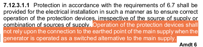

Can you please quote that section of SANS 10142-1 that says it is not legal? It is strange that it would be legal to connect the neutral to earth a second time, seeing that it is already connected to earth either in the main panel or at the supply transformer assuming a TN-S or a TNC-S system of earthing at the supply of the utility.I use the existing utility neutral with the inverter neutral without problems.No need to feed the inverter from the mains via a RCD. Treat the ac supply to the inverter as a dedicated circuit of the mains supply DB and add your RCD on the inverter output in the inverter AC panel.
And more stuff follows about separate neutrals when there is a UPS, and how your protection devices should not rely on the utility bond to function (ie, it pretty much tells you to install your own bond when running from the alternative supply).
It is pretty much a rule that only fault current is allowed on the earth wire. The moment you add a second bond, then you allow operating current to jump across from the neutral to the earth and continue the journey to the second bond where it transfers back onto the neutral... so between the two bonds you have operating current on an earth wire. That is not allowed.
43 minutes ago, SOLARWIND said:
bridge the neutral from the input to the output
Well actually I said that and he quoted it... but I just realised why this is not legal either. Selection_111.png.3588850f2c85093e5f3417738c91d0a8.png
Bridging the neutrals so the supply-side earth connection comes back into play... well that would be relying on this connection while switched.
So pretty much just one way to be legal: A bonding relay.
3 minutes ago, plonkster said:
"This earthed neutral bar shall be the only point at which the neutral of the installation is earthed."
That sums it up and means that the neutral of the mains supply DB complies and must be used as the common after the earthing point (where they are combined and then run as separate wires, each with its own function).
The bonding relay is then something that switches the neutral only, which is not allowed.
