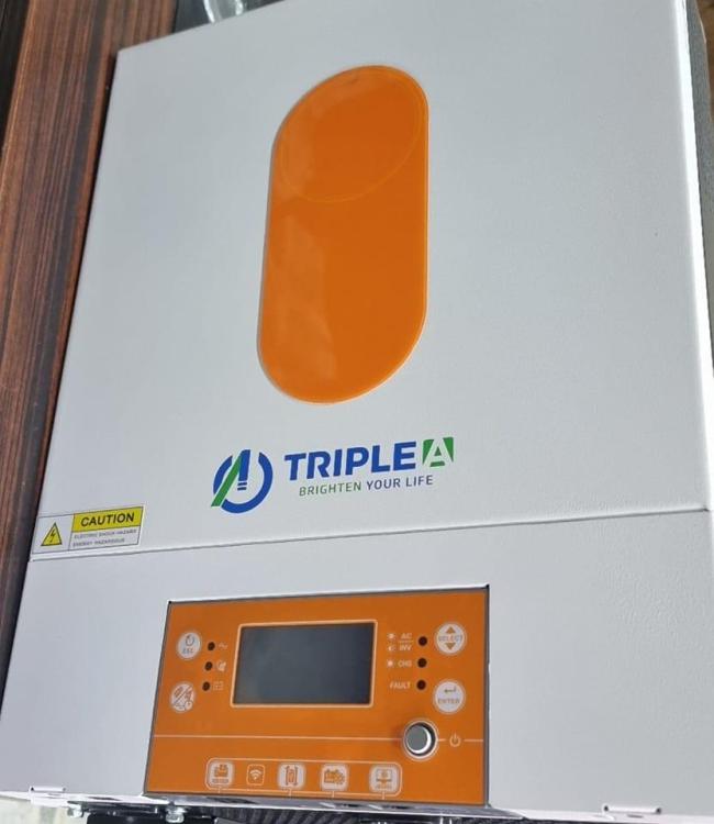

23 minutes ago, Khalil Koja said:
It's Triple A Brand
Ah! Do they look like this? I can't tell from the photo if those are switch buttons or touch buttons.
04a267e2-1029-4d2e-8b4e-188ad1de10dc.jpe
I note that Must inverters are not made by Voltronic, and often have non-Voltronic firmware (e.g. setting numbers different to that of Axpert, yet mostly do the same thing).
no this inverter from must mainfactor
im attached image for Triple A from voltronic
21 minutes ago, Coulomb said:
I assume that all models with the round/colour display have touch buttons; is that correct?
Yes only touch buttons.
25 minutes ago, Coulomb said:

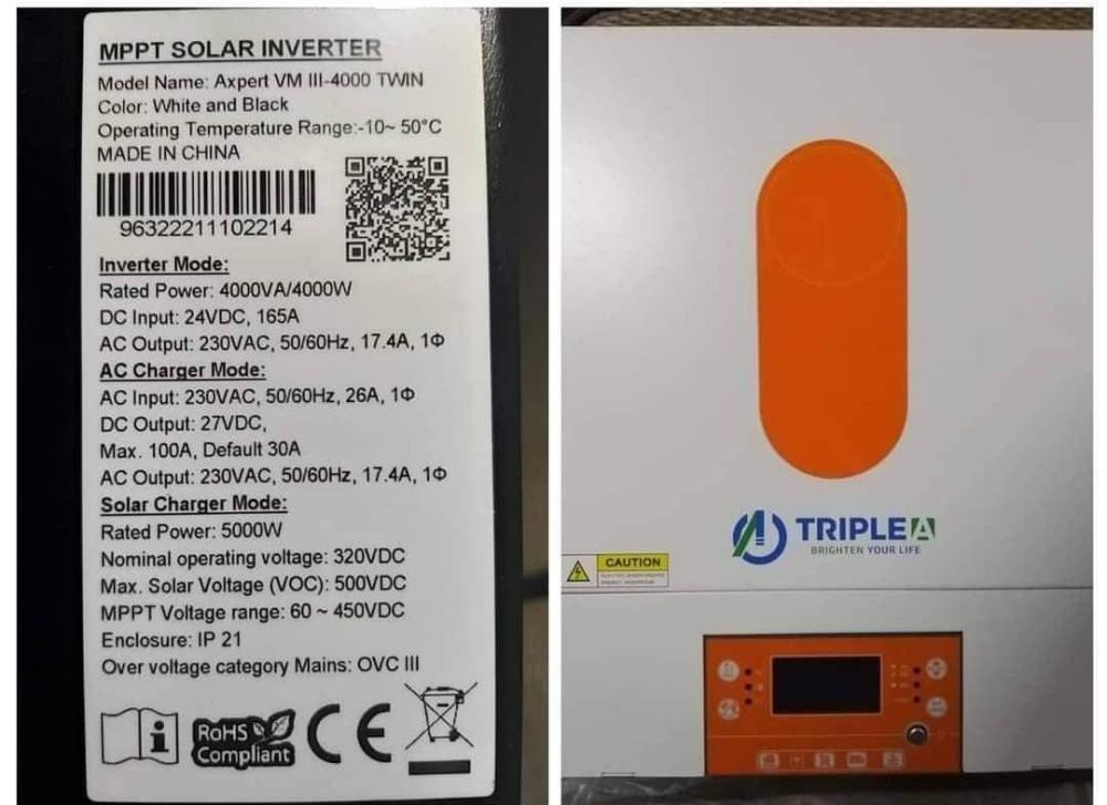

Just a description and perhaps a photo of these touch buttons, please. Now the multiplicity of display firmware versions is starting to make a little sense.
This VM III Twin TRIPLE A Brand:
15 minutes ago, esmail-kassir said:
@Coulomb the same as mine and @mohamed.kh , there is a photo for it in page 1
what is the brand name for this inverter who has the issue
Infinite Brand VM III Twin 6000W (physical buttons removable display)
Ah! Boy am I learning a lot today. So Triple A must be one of those resellers (like EASun and several others I believe) that rebrand Voltronic but also Must or other clone/workalike products. That QR code says "Originally manufactured by Voltronic Power". At last, a way of telling that an inverter is genuine!
I've noticed those orange removable displays years ago. But I foolishly assumed that it was just an artistic thing to "go with" the orange blob on top. Sigh.
Now I'll have to figure out how one of those buttons does up and down at the same time (at least, that's what it suggests to me).
Thanks for the lesson!
In touch buttons VM III you can only step in same direction to check other screens which is bad thing!

I have a Triple A inverter (Voltronic Axpert VM 3) paired with Felicity 200 48V batteries, and I’ve been encountering the ‘BP’ error at various intervals. Sometimes it happens once a day, while other times it may only occur once a month. When the error occurs, the alarm beeps, the error code appears briefly, then disappears after another beep, and the screen returns to normal. In some instances, I wake up to find the inverter completely powered off.
About two weeks ago, I woke up to find everything functioning normally, but I noticed the battery voltage was reading around 24V, even though my battery setup is 48V. Despite this, the system was still running and powering the loads, but the inverter wouldn’t charge the battery. I updated the firmware to version 60.76, and the issue seemed to be resolved.
However, this morning I woke up and found the inverter turned off again. After restarting it, everything appeared normal except for an incorrect time in the logs on the mobile application.
Does anyone know why the inverter shuts off like this?
Additionally, does anyone know why charging doesn’t completely stop when I select ‘charge only from solar’? It continues charging at 10A, with the charging LED remaining solid. It also pulse charges at 100%, but only when the grid is available; it doesn’t pulse charge via solar power.”

Since you have a monitoring app, please provide a data chart of your battery's voltage from the same day the inverter shutdown, so that we can check whether the voltage drop has some pattern or not. Additionally, if you can provide charts from several days having this sudden shutdown happening, it would be perfect for debugging! The best and fastest way to diagnose your problem is to test another inverter or another battery in your solar system, if possible.
