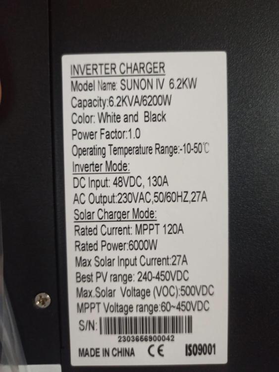

On 2024/08/11 at 2:24 PM, ImranKhanKhi said:
Thanks a lot @Coulomb & @Tarek Yag for the reply and guidance, yes it could be by chance or timing when Inverter soft bus was starting and it was damaged. Any way I will take inverter to the repair center.
Current version of Inverter are
U1 = 56.02
U2 = 25.05
Secondly, I am not sure either this is original Voltronic VM III TWIN or not but the board and display are the same as Voltronic. Please guide how to see if this is original Voltronic or not.
@Nabeel Raza Yes I am from Pakistan, please guide how to check its make or model.
Dear your inverter is 6kw model v4 twin comes in 4kw model twin means dual output. Does it have dual output you have to research on the Internet regarding your invert whether it is voltronic or not. If voltronic then which model of voltronic.
This has already been answered. He provided fair enough photos of his inverter and everything is obvious now. Thank you for trying to help.

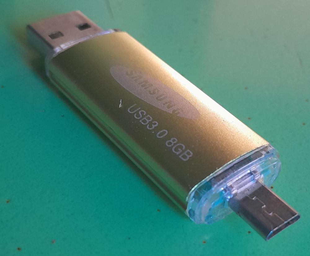

Hi, yes you can use a USB flash disk with a Micro-B connector (photo attached) and it's available in the market.
Carefully read and follow the instructions in this post by @Coulomb to prepare the USB thumb, then follow the steps of OTG upgrade from the inverter's manual.

is it ok to use otg converter/adapter ?
Yes, totally normal! All what is needed is a good brand, in a good working condition flash disk connected to the Micro-USB port, whatever the type of that flash disk is. Or, as you are trying to use an adapter with a flash disk, all is ok, just make sure that it is a good one.
On 2024/08/21 at 1:03 AM, mohamed.kh said:
It is not recommended to use OTG, as the ones used in mobile phones are not compatible with inverters
Not at all! I believe that OTG upgrading is easier and better than any other method for upgrading the DSP (U1) firmware. You don't need any other equipment in the normal circumstances, and you avoid using any other very low quality equipment (like USB to RS232) that are sold everywhere, which could end you up in more trouble than using OTG nice and clean.
