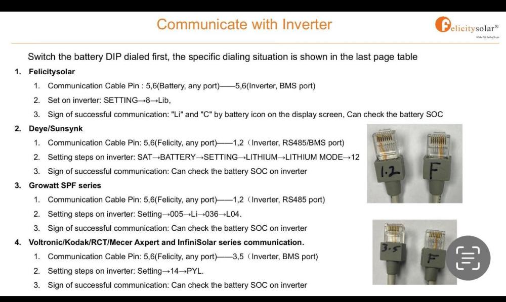

10 hours ago, ahmad almawal said:
من فضلك ، أريد حلا لمشكلتي المتمثلة في توصيل بطارية ليثيوم Felicity بعاكس 5KW. أظهر الجهاز الخطأ 61. هل يحتاج الجهاز إلى برنامج؟ لاحظ أن كابل التوصيل موجود على جانب البطارية 5 ' 6 وعلى جانب العاكس. 3 ' 5
You can check this user guide from Felicity. Also, try changing option number 5 (battery type) to LIB, Lic, or Pylontech—one of them should work if the cable pins are correct.

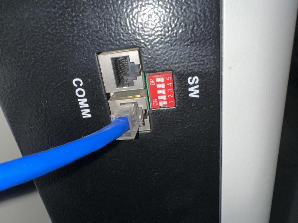

Additionally, change the DIP switch on the battery as I did. Remember to restart both the inverter and the battery to apply the changes if you adjust the DIP switch.
This revision improves clarity and smooths out the phrasing. Let me know if you’d like any further adjustments!
Here’s the Arabic translation:
يمكنك مراجعة دليل المستخدم من Felicity. حاول أيضًا تغيير الخيار رقم 5 (نوع البطارية) إلى LIB أو Lic أو Pylontech، يجب أن يعمل أحدهم إذا كانت دبابيس الكابل صحيحة.
غير مفتاح الديب سويتش كما موضح في الصورة المرفقة
وفي حال قمت بتغيره ، اطفي الانفيرتر و البطارية و شغلهم لتطبيق التغيرات

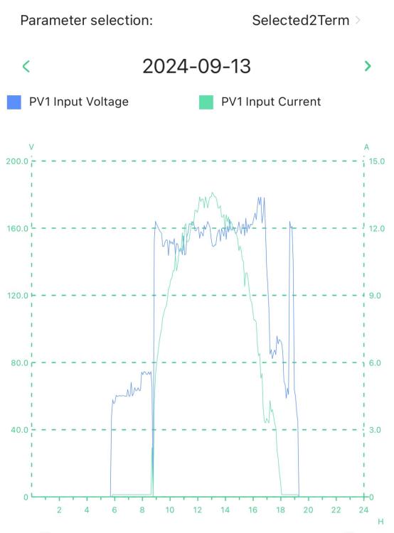

On 2024/09/09 at 9:28 PM, Tarek Yag said:
We've been hearing about this issue so much recently, but I'm still unable to figure out what's causing i
I upgraded to 60.87 and have the same issue (had 68.04) it seems to occur when put into solar only, despite being night. if I put util+sol or solar first it'll go back to its 4 amps it draws (can anyone else confirm an amp meter on this thing always says around 4amps regardless of the load is less???)
is there a way for a true bypass? I'd like for it to just bypass grid at night and shut off since I don't have batteries.

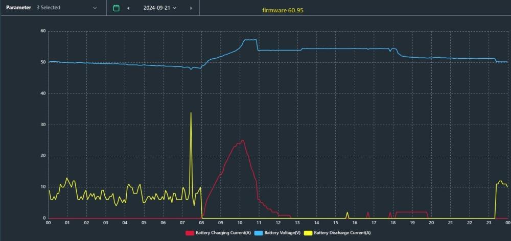

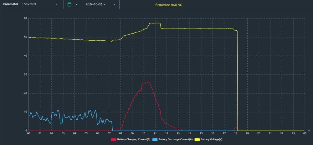

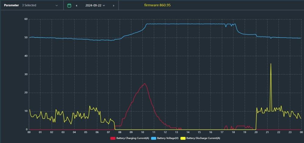

I have a MPP Solar PIP 6048MT (VM III Twin) 6KW inverter + 48V 220Ah AGM batteries, bulk voltage configured to 57.4V, float 54.4V, max charge current 30A, solar only charge.
I have updated inverter firmware from 60.95 to 860.95 (float bug only fix) and observed that it doesn't go to float, even if battery charge current drops to 0A. As long as it has PV available battery voltage stays at 57.4V.
I have attached 2 graphs, one from factory firmware 60.95, second one from 860.95.
What can be the cause for that behavior?
Is it something that I'm missing?
1 hour ago, roadrunner79 said:
Hi,

I have AGM, so I need bulk/absorption/float.
I've tried different settings in 860.95 (SUB, SBU, UTI, charge current, float/bulk voltages), no way to make it go to float, even if charge current is 0.
I will probably go back to 60.95.

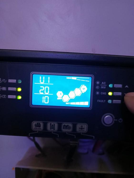

I faced other problem after the update
Max charging current reduced to 10amp
I tried to modify it many times but it return to 10amp after battery fully charged and not goes up again.

1-If my PV voltage is around 60 but with very little current
do I benefit from the firmware or I should have higher current
2- does this firmware has quite fans ? As I fOund that 60.95 and 60.87 much noisy that 60.76
No. Very low panel  current like that at a panel voltage towards the low end indicates that there just isn't significant solar insolation (potential solar power) available.
That what I thought :( , thank you ❤️
For curiosity, I flashed the 60.10 firmware with MCU 12.15 to my Axpert VM III Twin. Two new programs were added, 42 and 43 which I asked Voltronic about them and their response was:
Prog. 42 & 43 are used for below meter alarms. Prog. 42 for “Earth alarm” and Prog. 43 is for “Reverse alarm”.
And what mentioned in the updated user manual for VM III Twin about the two programs is:
I'm trying to understand the concept, so is there any thoughts?
Edited by AMalakani

Hi,
Below you can find a short comparison between 60.95 and 860.96.
On a good day looks like they have similar behavior.
Will have to see what happens on a cloudy day.
BR.
