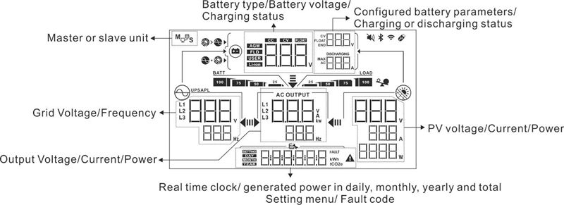

Does the VM VI with the round display has icons for those alerts?
No, not at all. Attached here is the complete display layout showing all possible icons. Taken from my VM IV Twin User Manual, it's the same for the Twin and Non-Twin variants.
