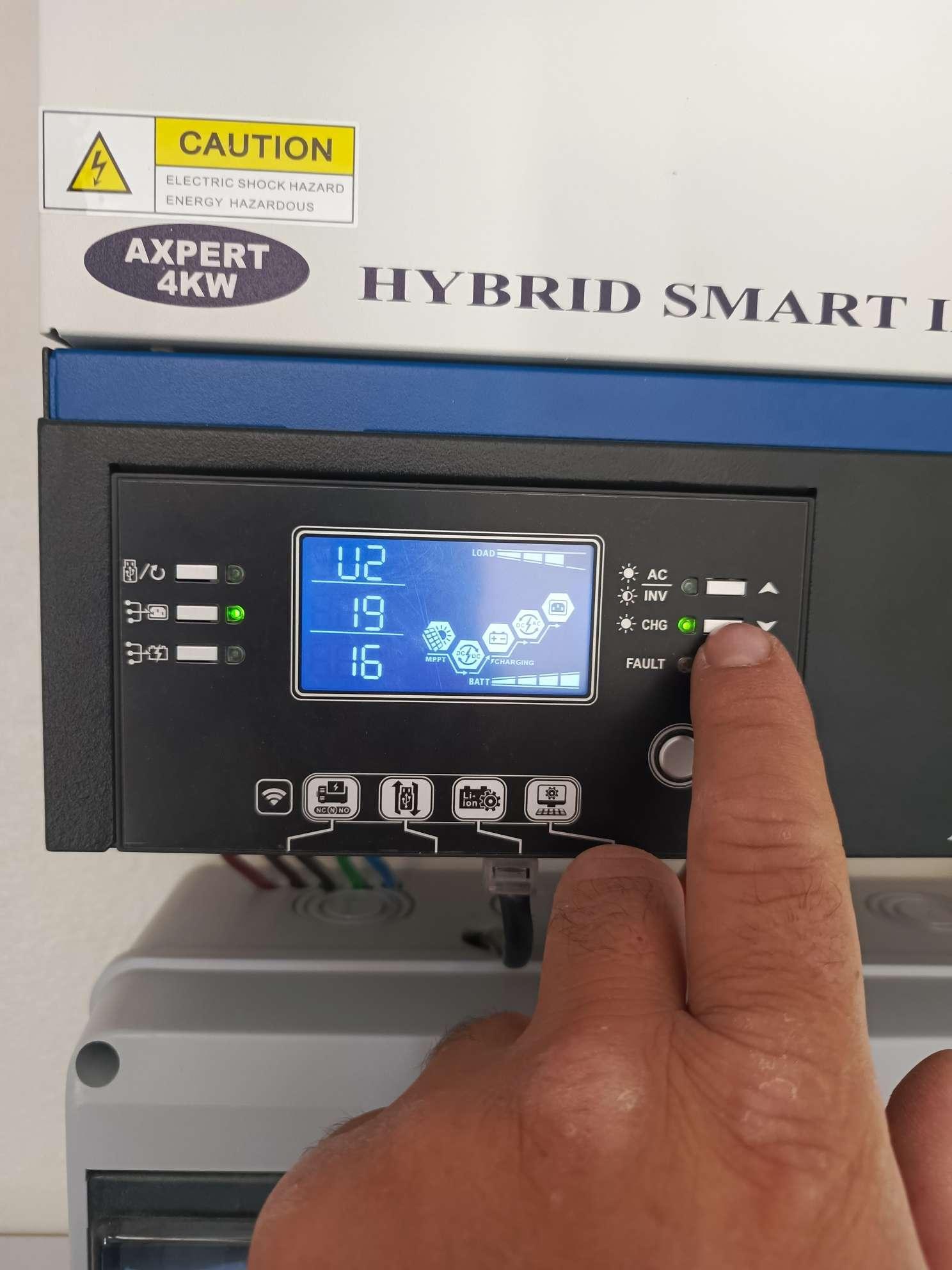

On 2024/11/17 at 6:33 AM, ahmad almawal said:
I have an AXPERT VM VI 4KW inverter
Are you sure it's a VM VI (six! I've not seen even V (five) yet!)
It seems more like a new style VM III. Or maybe an MKS IV (not the same as a VM IV), which has twice the flash space, and is parallelable.
Unfortunately, the 72.xx numbering is the most conflicted of all.
Please post photos, or manufacturer or reseller's link, or tell us what type of display is has, and how many buttons, and if touch or ordinary buttons.
So far, those firmwares don't look remotely compatible.

هذه صورة للعاكس والشاشة.
Hmmm. That QR code seems to decode to "You successfully scan QR code".
The label doesn't look quite right. The first 4 digits of the serial number (9632) aren't a pattern that I've seen, but I haven't been seeking them out lately.
I get the feeling that this is a clone, and the firmware is a copy of some unknown Voltronic firmware.
It's obviously not a copy of a VM IV (no round display), and the display is at the very left like a VM III, and the MPPT range is 60-450 V like a VM III. So my guess is that it's a VM III clone. Probably a non-twin, since I'd expect a Twin model to say so on the label (but that's just what I'd expect, not definite at all). Also, 19.xx is a Voltronic non-Twin display firmware for the new style VM IIIs. But you can tell if it has two AC output terminals; if so, it's a Twin, if not, it's a non-Twin.
Since the VM models all use the same processor chip ('28062), it's possible that this inverter is compatible with Voltronic 55.xx firmware. The only one of these in my collection us 55.06, and it's from October 2022. I see from your serial number that your inverter is from early 2023, so whatever that 72.00 firmware is, it's probably more recent than that.
You could possibly update to Voltronic display firmware version 19.18, but there doesn't seem much point, and plenty of risk.
