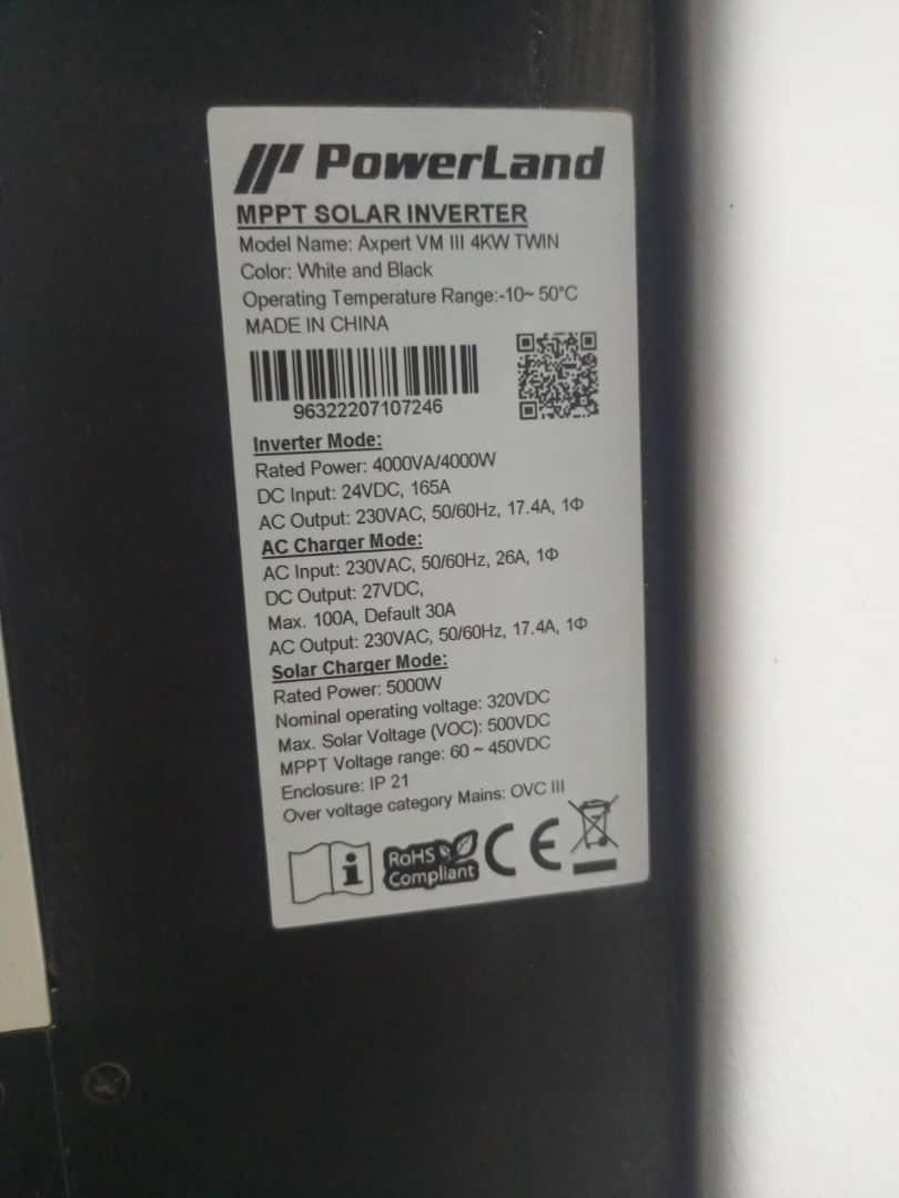

That appears  to be a VM IV 5.6 kW Twin. Both the DSP 12.xx and the display 63.xx are quite rare. I have no firmware update files for either of those, sorry.
[ Edit: Sigh! I see that the sticker says that it's rated at 8000W. So now I have no idea what that firmware is. ]
It might be possible to update to a later main (DSP, U1) VM III or VM IV 5.6 kW  Twin firmware with a different major firmware version number, but I strongly do not recommend it.

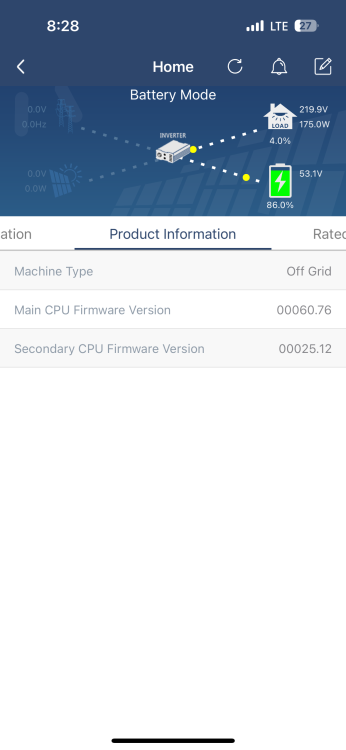

The MPPT behavior looks identical for all these firmware for me ( unfortunately most of the test was during summer so it could be some different during winter)and If I am not wrong  @Coulomb couldn't find any different in MPPT code in those firmware (except the patched ones )
currently I am satisfied with 60.76 (no fan noise and decent PV input )
