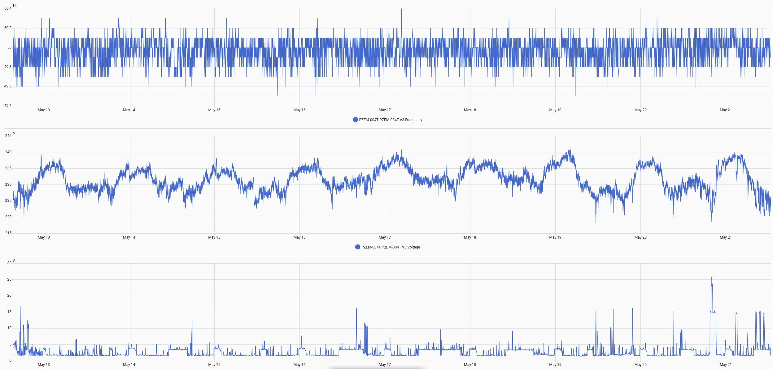

Fluctuating grid frequency in Pretoria
1 hour ago, Pho3niX90 said:
I would have thought, that in instances of cloud coverage etc, the instant power fed back into the grid would increase the Hz
Frequency is controlled by large power plants and grid operators, not small distributed generators.(SSEG)
If too much generation is injected and demand is low, the grid operator (e.g., Eskom) will reduce power from larger sources to maintain 50Hz.

6 hours ago, Pho3niX90 said:
Private solar (October 2024) = 8970 Mw
8097MW seems like a more plausible number. Cloud cover events can't affect the whole country to cause rapid changes in frequency. Cloud cover over the whole country in winter (cold front) will cause load shedding.
