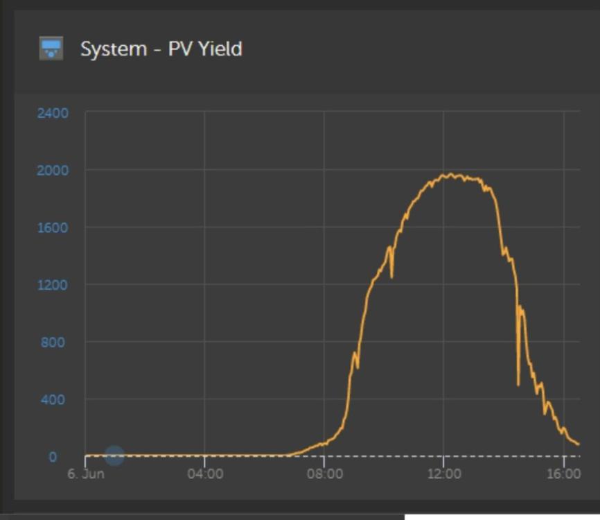

I’m seeing a flat plateau in my PV production curve during peak hours (as shown in the chart from 2026-03-10), and I’m trying to understand the root cause.
My system specs:
∙ Inverter: Felicity 5kW with dual MPPT inputs, each rated at 15A max
∙ Array: 7 panels × 580W = 4,060W total
∙ Measured voltage during plateau: ~300V
∙ Measured current: 11.2A – 11.8A
Observations:
∙ Production ramps up normally in the morning, then hits a hard ceiling around 3,500W and stays flat for several hours instead of forming the expected bell curve
∙ pleaee ignore a noticeable dip and spike around 15:25 , it is because the battery almost full+ no load and grid was off ( so can’t export )
My questions:
1. Is this classic inverter clipping caused by the array’s power exceeding the inverter’s rated output?
2. Could the 15A per MPPT limit be the bottleneck here, even though my measured current is only ~11.8A?
Any insights would be appreciated. Thanks!
10 hours ago, esmail-kassir said:
... Production ramps up normally in the morning, then hits a hard ceiling around 3,500W and stays flat for several hours instead of forming the expected bell curve
Solar panels are rated at "Standard Test Conditions" - thus under laboratory conditions (assuming, amongst others, a radiation intensity of 1000W/m2), and without taking system losses into account.
"Real World" maximum output is normally about 75% - 85% of this, due to solar intensity being less (dust or moisture in the air blocking some sunlight, light "striking angle" being less than optimum, system losses, temperature of panels, etc. etc.)
Your 3500W is pretty close to 85% - You should be happy that your system is running in the upper range of achievable performance...
Of course, you would also get the same flat peak if your demand remains constant during this period - PV panels only produce what is demanded by the system, and nothing more...

Have you got graphs of the PV voltage and current - might reveal a more obvious clipping. But that change in the graph at 12h15 definitely looks like clipping. Below shows my PV current and you can clearly see the clipping - I have 5kw Sunsynks with a max PV current of 13A and panels that can do 13.5A. The mesured clipped current here is 12.8 so slightly below 13A but close enough that I live with it.

All speculation. First check maybe if you've got a battery charge rate limit set to around 70A. The solar panels will only produce what the battery system demands.
Beyond that, I'm assuming your 7 panels are installed on one MPPT. Could obviously be wrong, I don't know. I'm wondering whether that inverter has set a limit on the power that one MPPT can produce. Considering the low start-up Voltage on your inverter, I'd try to spread the workload and experiment with connecting the panels in strings of 4 and 3 onto each MPPT and see if it makes a difference at mid-day. Three panels are obviously borderline on the low Voltage end, but the point would be to test if you can go above 3500W in total at noon when the Voltage is expected to be sufficient, and then you could consider based on what you see, whether to return to 7 in series, or add one panel to go 4+4.

The graph suggests that the PV output is being limited by the inverter’s MPPT or system settings, rather than the solar array reaching its natural maximum. The flat plateau indicates the inverter is capping the power, not that the array cannot produce more.
It would be worth investigating inverter-side limits, such as battery charge current limits or other configuration settings that could be restricting PV production.
For comparison, here is a VRM graph from a system where the array actually reaches its production ceiling. The array consists of 6 × 460 W panels (2760 W theoretical), yet the maximum observed production is around 2000 W, which reflects real-world conditions rather than an inverter-imposed limit.
In this case the shape of the op's curve suggests inverter limitation rather than array limitation.
I think that the answer to this is possibly quite a lot simpler than most of you are looking for
I suspect that the inverter is just getting to hot and is therefore limiting the amount of solar power coming in
I find this quite often in inverters that don't have active cooling or inadequate ventilation
