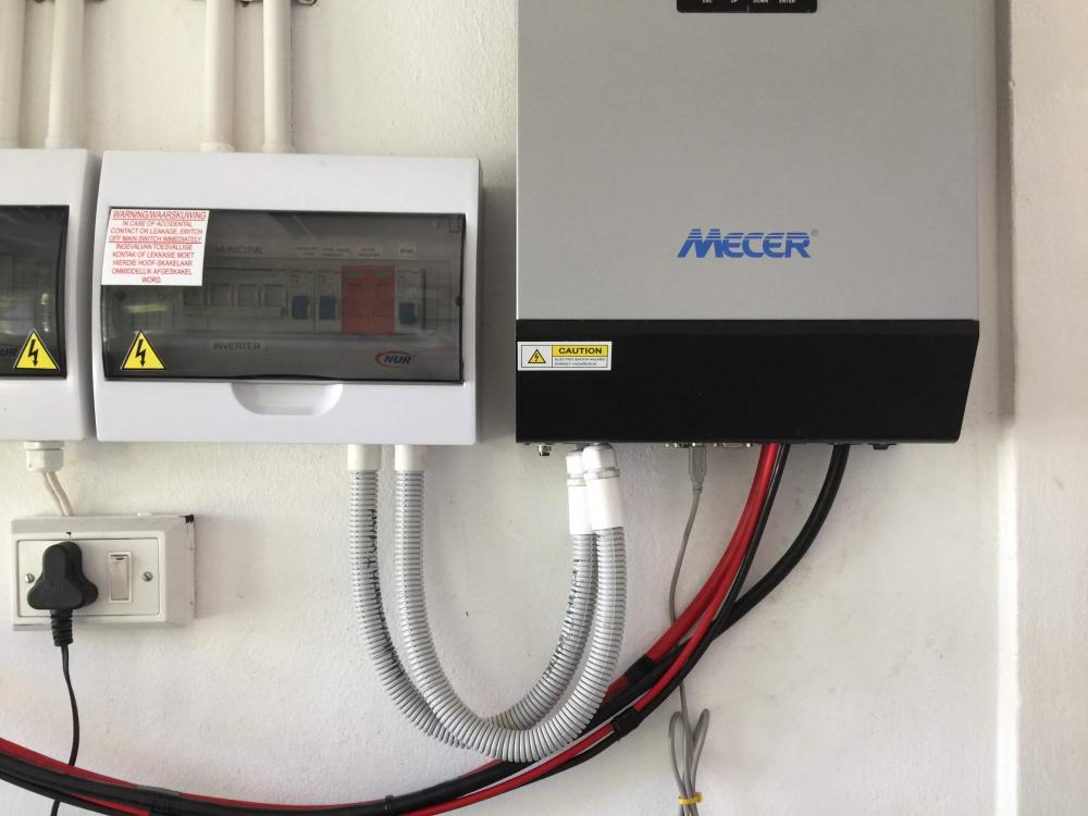

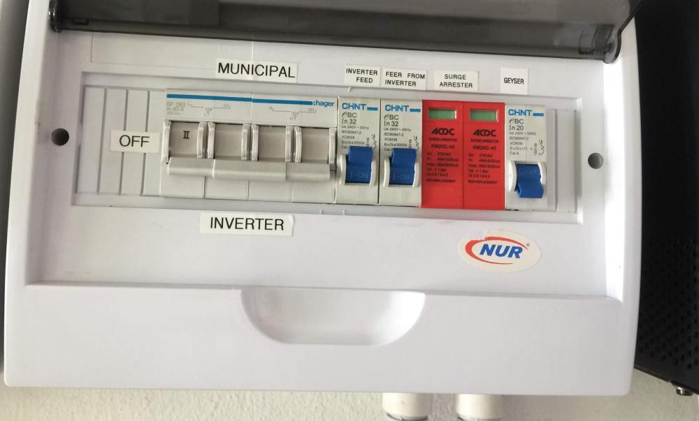

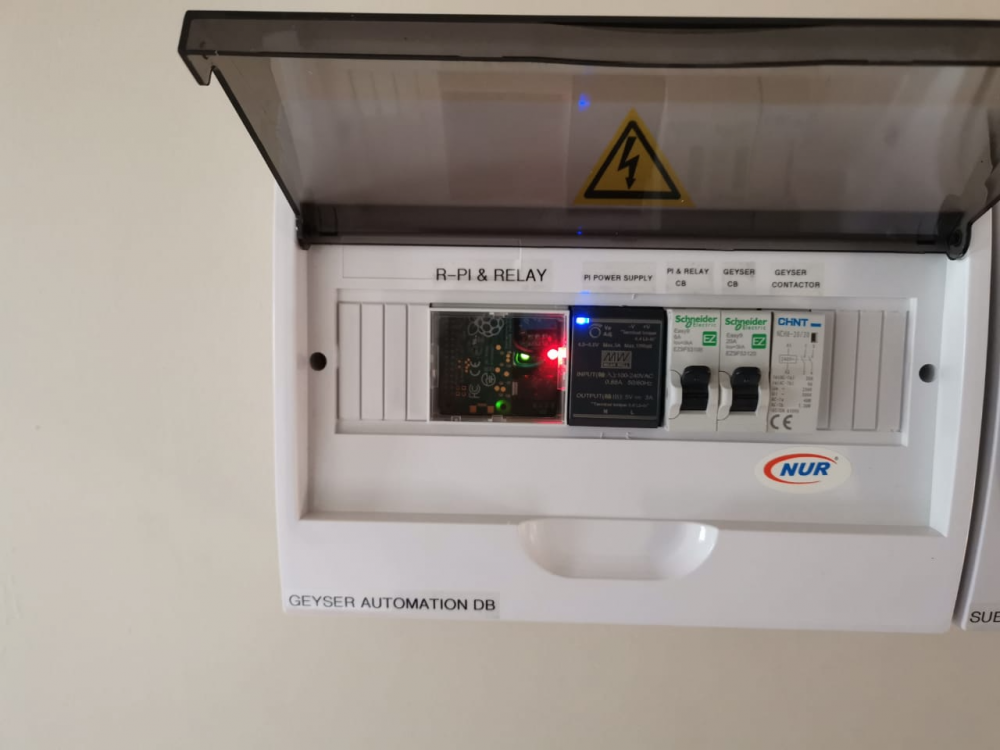

June 10, 20197 yr Recently ditched my stupid timer And built this: *Already installed this for 2 of my customers who are quite happy with how it all works* Raspberry Pi Controlled Geyser Timer. Components used: 1. Raspberry Pi Zero 2. Relay to drive the contactor 3. Din Rail 220~240v to 5v DC Power Supply for the Pi 4. 1 x 6A CB for to supply power to the above 5. 20A CB for the Geyser 6. 20A Contactor for the geyser Outstanding for my setup: 25amp changeover switch to bypass the Raspberry Pi controlled system incase something goes wrong with the pi. Integrated with google assistant so I can tell google via voice commands when to switch on and off, this will override the automatic timers. Emails alerts as well to notify me when the timer kicks in. Working on the LCD display with temperature and current sensor next......
June 10, 20197 yr Thing to watch out for: Cold water because the SD-card failed... 🙂 I am always very wary of unexpected cold water issues. The long-haired folks don't like that...
June 10, 20197 yr Author 44 minutes ago, plonkster said: Thing to watch out for: Cold water because the SD-card failed... 🙂 I am always very wary of unexpected cold water issues. The long-haired folks don't like that... I am bald lol... The pi is monitored by both external and internal servers so will get emails upon failure. Just need to prepare myself to sleep on the couch the day I actually miss the alert 🤣

June 5, 20215 yr On 2019/06/10 at 12:44 PM, Treschen said: Recently ditched my stupid timer And built this: *Already installed this for 2 of my customers who are quite happy with how it all works* Erm, cool and all but this isn't a SANS complaint installation. Any CoC you issue for this would be invalid because you can't just stick anything in a DB and call it a day. They need appropriate SANS ratings. If you install this for enough people and they start reporting you or take you to court, you can get in serious trouble. Device certification is much more strict than the actual CoC. Edited June 5, 20215 yr by Gnome
