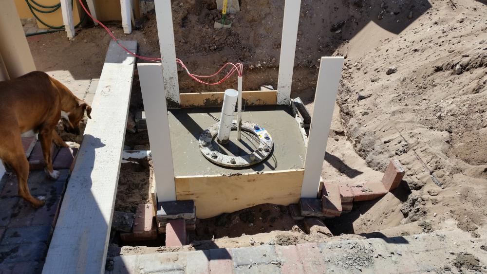

Today i got the time to weld up my mounting structure with a reinforcing web, now to dig a 2m x 2m x 1.2m deep hole.....think i will do the concrete on Monday..
How did the concrete go?  If you haven't done it yet I would suggest covering all the nuts and threads with plastic bags and tape!
busy with the top boxed segment, should be finished within the hour..... 2 cub stone, 3 cub sand , and 10 pockets cement yesterday,  it aint gonna move anywhere!!!!

1 hour ago, plonkster said:
Did you get an engineer to spec that, or are you doing the normal "farmer" thing where you simply make it large enough so that any idiot can see it's going nowhere? :-)
Nope got the schematics, Bill of quantities an all!! what you take me for???   lol
but must admit i have used the spec for the 5kw unit with variable blades, as i know i am going there one day again......

Hehehe, obviously you're an old hand at this. But I know that Farmer thing. I have family like that. Use pipe that's twice as thick as necessary to make gates. That thing is never breaking... the pole next to it will break but not that thing. Even if you farm with Brahman cattle...
true, must admit i do also do the farmer thing on occasion, just did not want to risk it with a 1 ton hydraulic 9m monopole

ja, furthest i can go legally with foundation, also not privileged with a 70m or larger plot length like the farmers out here.... but at least i am 9m up, 6 m above high point. just the garage on the left of it.. fortunately the wind comes from SSE and NNW.

i have a temp cable run of 6mm, but i am hunting for that orange flexible 10mm cable hence the 100mm pipe for extra's. the 6mm should work for 3 phase but it is only temp
