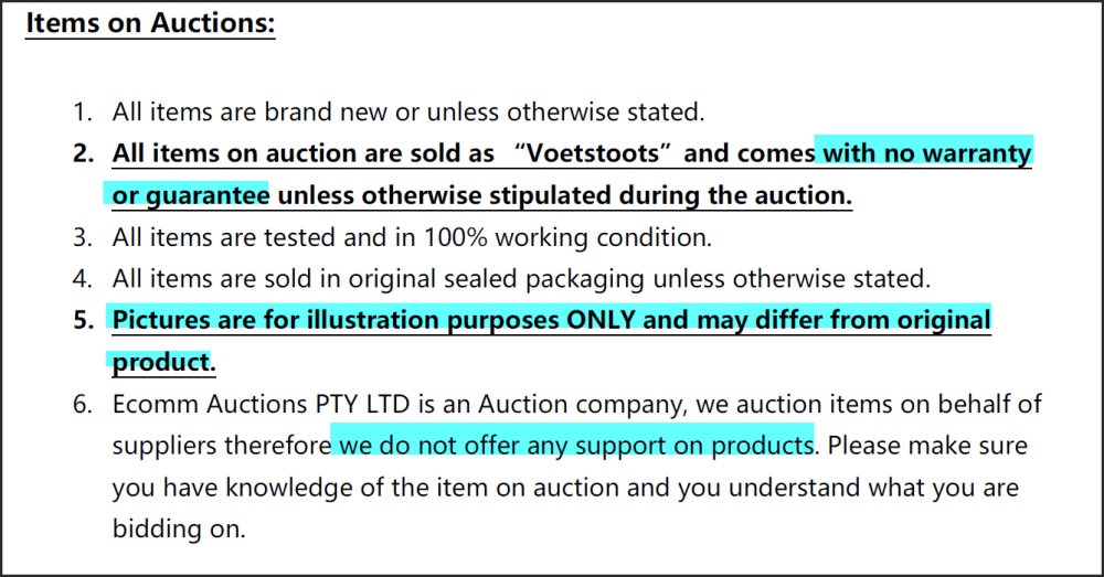

You also might not get what you bid on. Don't be fooled by the pictures.

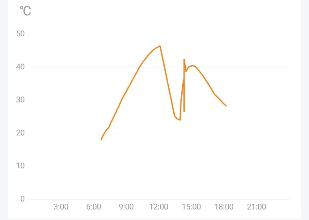

Assuming I’ve picked the correct field for temperature, my well-ventilated Sunsynk 5kW runs just as hot as this when charging: 30 minutes of post-loadshedding charging at just 2.5kW (at night with no PV) has it at the same temperature as in the Fivestar picture - and during the day when it’s inverting PV, it easily hits north of 65 degrees (!) Celsius…
So they run hot, too! Although reports of overheating are rare so presumably the thermal design caters for it. (Or so I hope!)

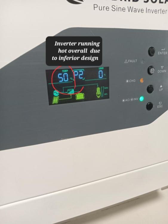

 If your inverter is consistently reaching 65 degrees Celsius, you might want to consider improving its cooling or ventilation to ensure proper functioning.
The Fivestar inverter in my picture was charging at 20 amps(960 watts) and reaching 50°C and sometimes went up to 62°C in a well ventilated area in my book 65° is quite hot should the ambient temp rise you might have a problem.

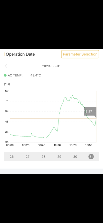

I presume my inverter without fans that shows this temperature when working at 87% of full power is pretty good.
Low temperature was during LS and not in operation.
Interesting! Is that also the 5kW Sunsynk? EDIT: Looks like this is a Mecer 3kVA. Checked with several colleagues and it seems the > 50 temps above are reasonably typical; I'm assuming the inverter is built to handle them. I guess it's more about overall thermal design than raw temparature.
