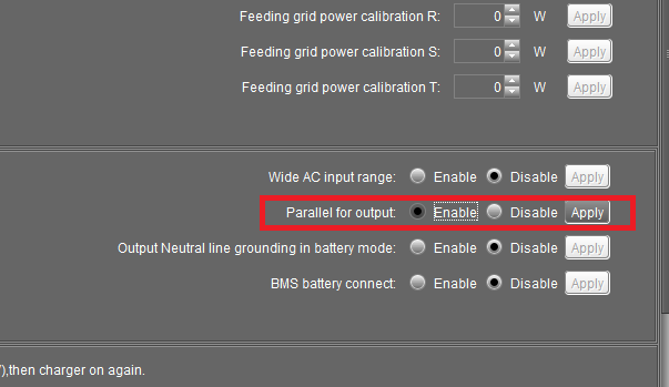

BTW: You are absolutely sure, that you configured both inverters correctly for parallel mode?
In a word, no. What am I supposed to configure?
I just hooked the cables up as per the manual and immediately got error 71 which the manual said is firmware not compatible; so I figured the firmware isn't compatible...
In any case, I should do FW 2020/04/02 on the "real" yellowish screen infini and if it doesn't take it then you have a 22/09/01 which would likely allow me to recover it to something that works?
Ah I'm glad it's just that; yes I believe they both had that ticked by default and I have just checked they both have it ticked for parallel operation.

Attached is wattage per phase going into the inverters from grid; this would ideally be 0w during premium rate grid tariff in the day.
I see a setting for R S & T "feeding grid power calibration" do you know if I could set an adjustment there? Or somewhere else to stop this constant draw from grid at expensive rate? The constant 750w during peak time costs £6-£7 per day currently.
