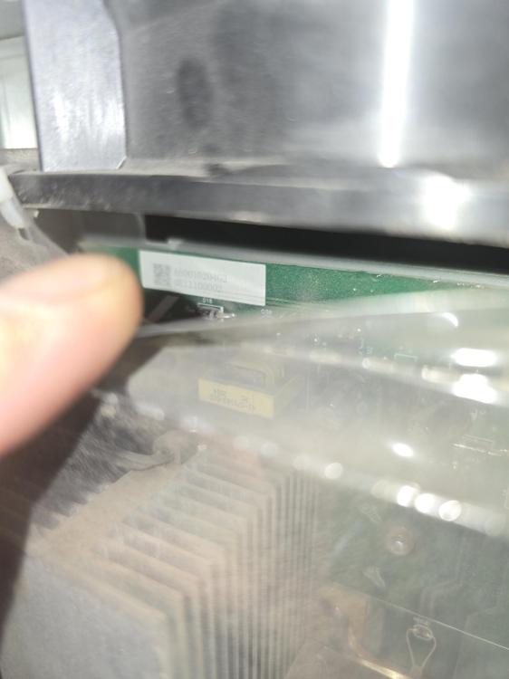

Your device should be able to be upgraded to latest version (2024-09-03). To be absolutely sure, you would have to post a picture of the CPU board installed (inside the inverter on the back side).

Infini 10k-par-B with sn 96161906*******
Control board model is 2662
Thanks alot in advance
