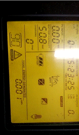

 hi
do you have soloution of 90 error in infini 10kw
its about serial no error do you have file to add a serial no218948379_90error.GIF.f89707e8d0c7922600634efd60cc442b.GIF

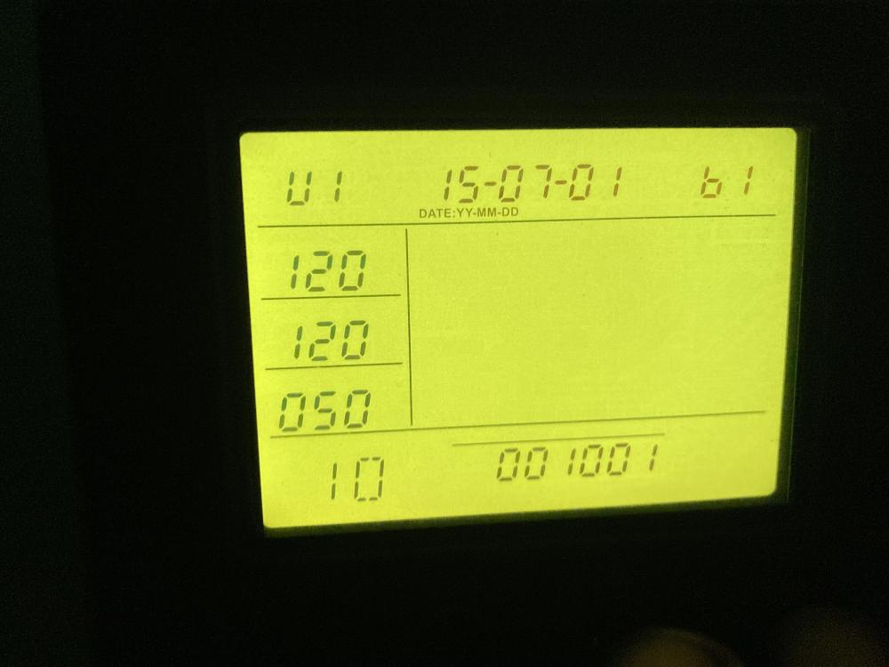

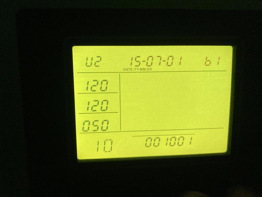

The password of fw files from the czech site is "daily".
But be warned: Not every FW for the 10k infini works on all models!!!
You have to choose the right one based on your serial# which includes the production date. I can assist.
To see correct version currently installed (compilation date/time) u have to press UP+DOWN simultaneously for a few sec.

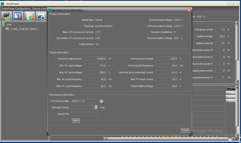

35 minutes ago, riogrande75 said:
What inverter do you have exactly (pic of type/serial would be helpful) and what fw version does it run currently?
10kW Infini solar inverter. The latest version I have is V6.02, I have another V1.01, so trying to upgrade V1.01 to be compatible with V6.02
That seems like a wide gap to bridge.
I'm suspecting that one of them is a clone with who knows what firmware in there.
Pictures of the stickers on the side would be very helpful.
So far I did not see any firmware version other than 1.01 on Infinisolar 10k and it's clones (FSP,MPP,EASUN,PANTA,...). So this is absolutely meaningless.
As stated above, the firmware compilation date (U1/U2, press UP+DOWN) is the only important notice.
Also production date (can be extracted from serial#) is crucial - this tells the hw generation of the inverter (non parallel, parallel-A, parallel-B,...).
Edited by riogrande75

The fw you installed is for brand new devices (2022 and up). I expect that it fits only on the latest generation of cpu mainboards.
What serial# does your inverter have? Based on that I can suggest the latest firmware for your device.
