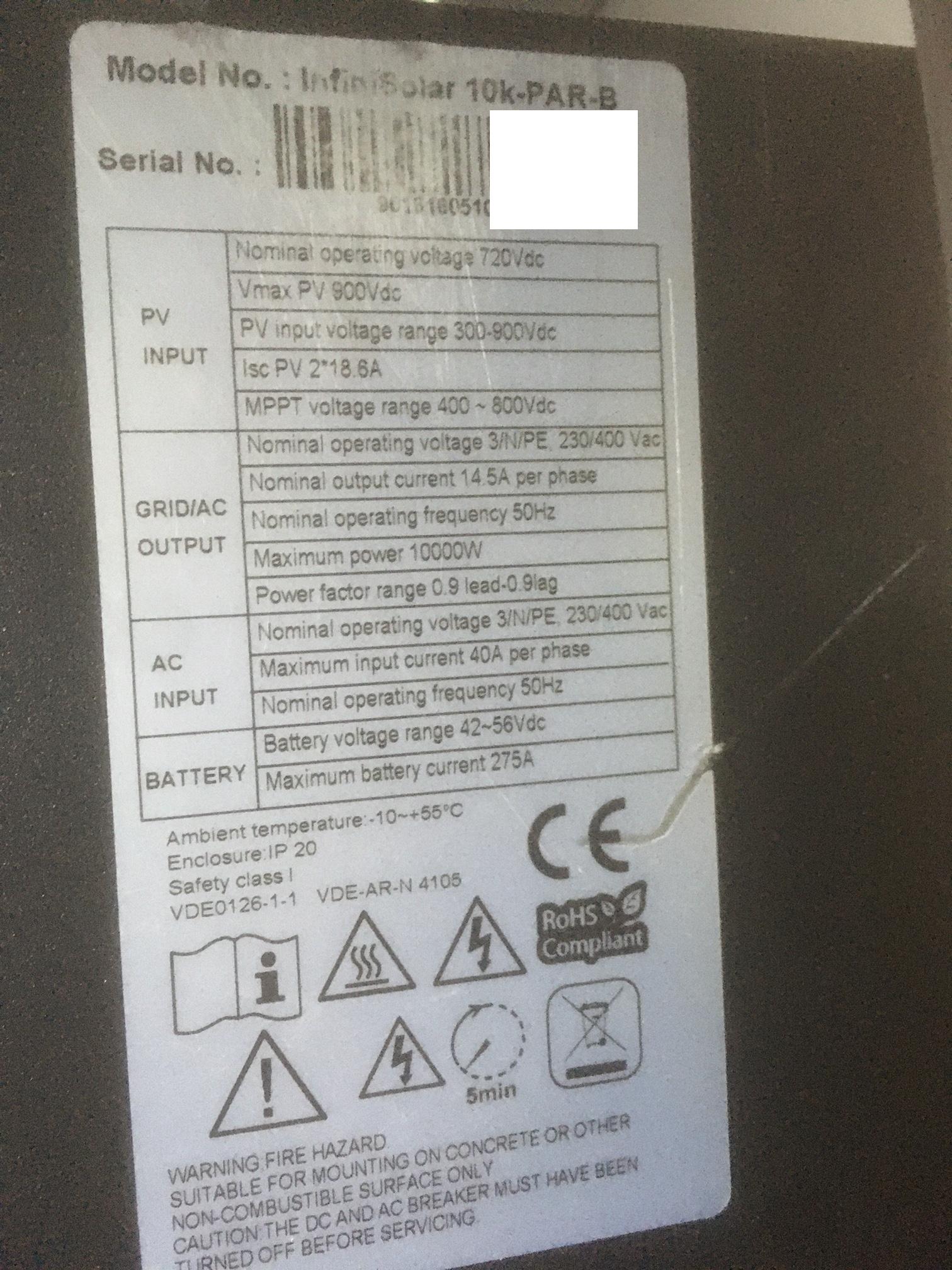

    What inverter do you have exactly (pic of type/serial would be helpful) and what fw version does it run currently?

Do you have a debug log from SolarPower from before the upgrades? Just to be sure to have the "real" serial#, there are lot's of fake clones arround.
Everything sounds pretty strange...
Can you post a photo of the type shield?
I think we have real serial, on both inverters serial on solarpower and sticker are the same, wifi showed correct serial and was corect communication with power-datacenter.com, there was corect serial number also
Looks ok, seem to be a original Infini 10k.
