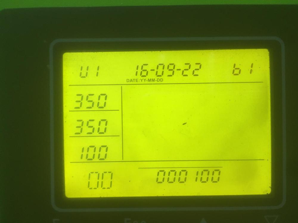

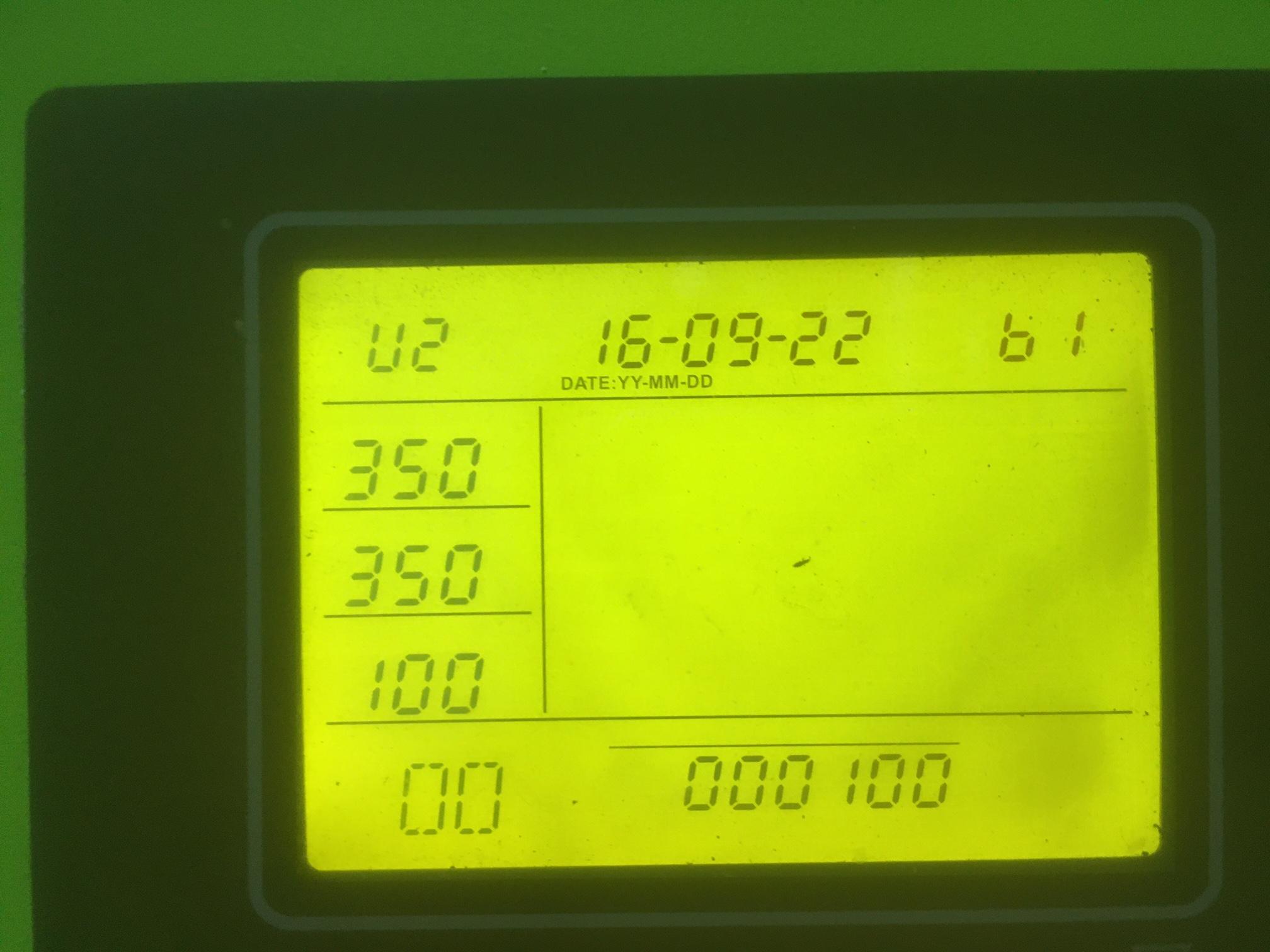

October 24, 20232 yr Hello, I would like to upgrade firmware in my 2xinfini10k, both of them are ParalelB with SN 96161605100XXX. Solar power shows CPU Board version 3.5 and 3.5. Up and Down shows on display U1 and U2, 350 100 00 00100 Please advice me, what version firmware I should upload to them. Best regards Rafa.moko
October 25, 20232 yr According to the serial# your inverters are quite old (built May 2016). But I guess 2020-04 (pre 1809) firmware would fit as they are already PAR-B. To be more safe, you need to be sure what fw is installed currently. But this is strange: U1 and U2 should come up with a date/time, what you've posted doesn't look like that.
October 25, 20232 yr Hello, I'm sending picture with all readings, I confirm ParallelB on the sticker. Thanks for you time.
October 25, 20232 yr Ok, you obviously run FW 16-09-22 (22. sept. 2016), so pretty old. Oldest FW I know for the first parallel models. I suggest to install latest fw available for this kind of model: Infini10KWParallelA20200402DP This one adds BMS support, AC overload charging and includes lots of other fixes. I run it on some of my devices for years without any issue. Off course installation is on your own risk, but it's pretty save anyway as you can always install any other firmware again, even this one makes problems. So you are even able to revert your inverter to the actual running firmware using this files: Infini10KWParallel20160922P Keep in mind to remove any card from options slot for the upgrade! Good luck, Rio

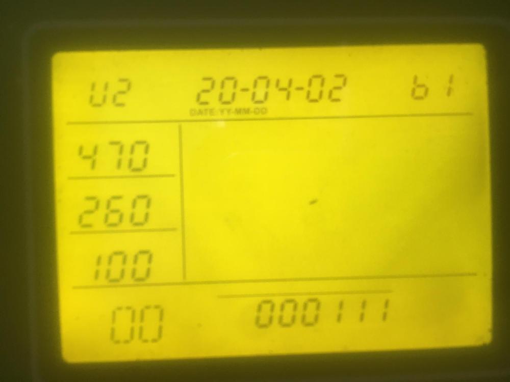

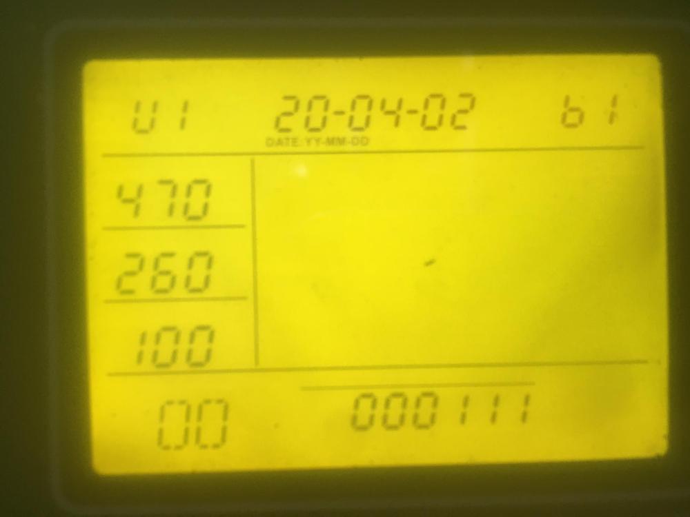

October 25, 20232 yr Thank again, mine is PAR-B, so what you said makes sense, i'm running upgrade with Infini10KWParallelA20200402DP. I will let you know when i finish job.
October 25, 20232 yr Hi, succsfully upgraded, with no errors. But now, inwerter won't switch production from solar, it see 630V on both strings but nothing more. WHen I connest over usb solarpower I can see 00000000000000 instead serial numer on the left pane
