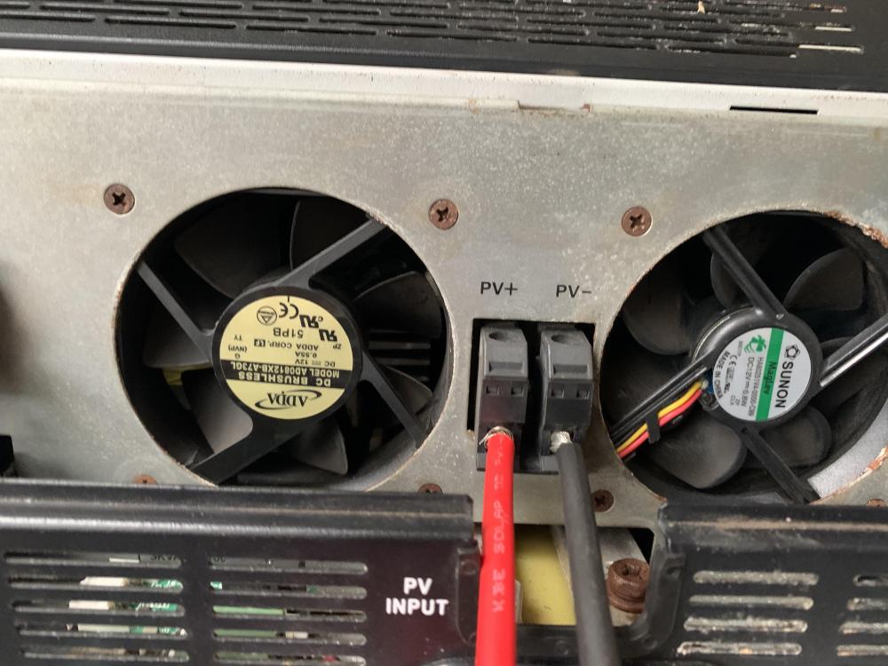

I'm getting 01 Fan Warning on my 3kva 24V MKS Plus. The one fan has been replaced by the previous owner. Both are spinning when the inverter starts up. Can anyone tell me which is the original one and where I can source a copy to replace the other one with in order to get rid of the warning?

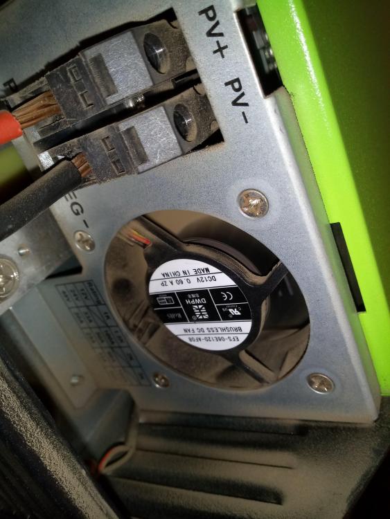

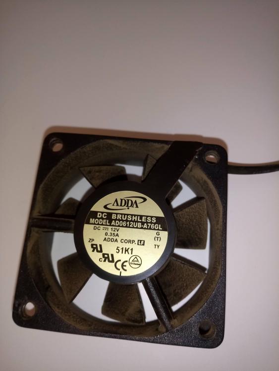

The SUNON is the wrong fan . Seems they made the hole larger to fit it . The right fan is only 60x60 . The ADDA fan only have 3 wires not 4 like the 5kW . The 2nd photo is a fan from a later version .
